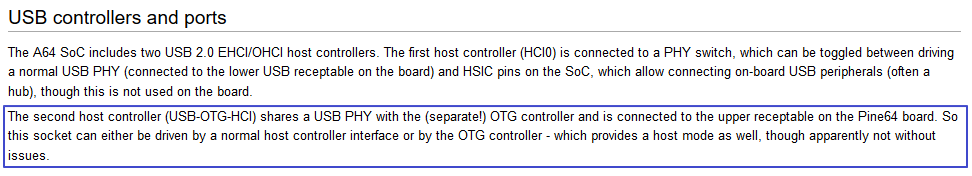

(03-20-2017, 04:14 AM)MarkHaysHarris777 Wrote: Both of the usb ports are usb2.0 and can be used for things like drives, keyboards, and even cameras;  however, only the bottom port can be used OTG (the usb port closest to the board).
Are you sure about that Marcus? It is documented as being the top port.
traditionally, it has been the cabling. A cable as host device, b as peripheral. maybe that is how pine64 works it. if so then the camera will need b cabling. as a side note, i think there are apps that can determine if a device, in this case pine64, are OTG compatible, or if so, if they are host ready.
Thank you!   What is the source of the thumb nail ?   Also, then that means that the FEL port (top) is the same as the OTG hardware port  too (top) ?  I've looked through the SoC user manual, but apparently I missed it;  can you provide a page number?
Note:  I did confirm through reliable sources on-line (irc) that the FEL port (top usb port) is the OTG hardware port (furthest from the board vertically).
If the board is booted without the SD card in place the machine goes into FEL mode , and the pine board (using FEL port) will be visible to the PC as a device-- the pc will be able to write to the pine memory , and read the pine memory (although, not immediately useful, it is a cool academic exercise);  however,  when booted in gnu+linux there isn't a usb OTG controller available , so with linux only two (2) usb2.0 host ports are available;  no OTG port is available.

(03-20-2017, 05:57 AM)MarkHaysHarris777 Wrote: Thank you!   What is the source of the thumb nail ?   Also, then that means that the FEL port (top) is the same as the OTG hardware port  too (top) ?  I've looked through the SoC user manual, but apparently I missed it;  can you provide a page number?
The linux-sunxi Pine64 wiki link in my signature.
The A64 datasheet talks about the USB peripherals under 2.9 External Peripherals -> USB Controller. USB OTG is also covered in the A64 User Manual at 7.5.2 USB OTG.
On AllWinner SoCs, you put the device into FEL mode (usually via a switch or jumper) , and you then boot using the USB OTG port. There is no "fel port"... FEL mode is the mode the CPU goes into to boot via the USB OTG port.
