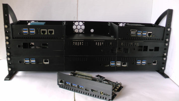

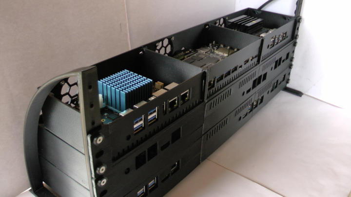

The Rack case has many options and can produce a variety of rack bays in either 10" or 19" width.  There are brackets available to make a table top stand for those who currently don't have a stationary rack.  Shouldered washers that use 3mm hardware can also be printed for use with the table top stand.  Both are available in sbccb_accessory_tool.scad.
Rack Case Features
- 19” and 10” rack support
- 1U-2U case height
- 6 bays (19”) or 3 bays (10”)
- 4 bay types – fixed, open, removable, vent
- Multi heterogeneous SBC with individual location and rotation
- Removable SBC support
- Divider wall individual enable
- Bays can be combined for larger bays
- Rear fan per bay with individual enable
- Top and bottom vent covers
- Bay cable management – conduit, single or double split sleeve grommet
- Accessory subsystem support
The rack cases are divided into approximately 150mm wide parts for printing and use M2 hardware for assembly.
