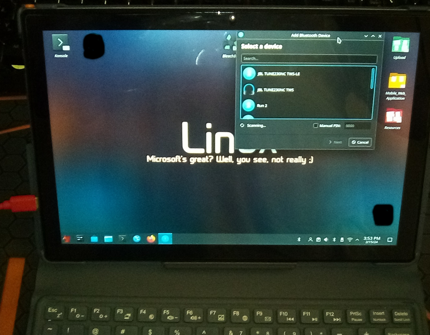

Thought I’d add Bluetooth is fine and functional with all of my devices (JBL & Maxell) earbuds and external speakers.
As of 15/02, fully updated, the stop job doesn’t hang as much and no issues connecting to Cisco AP’s/Mobile Hotspots.
