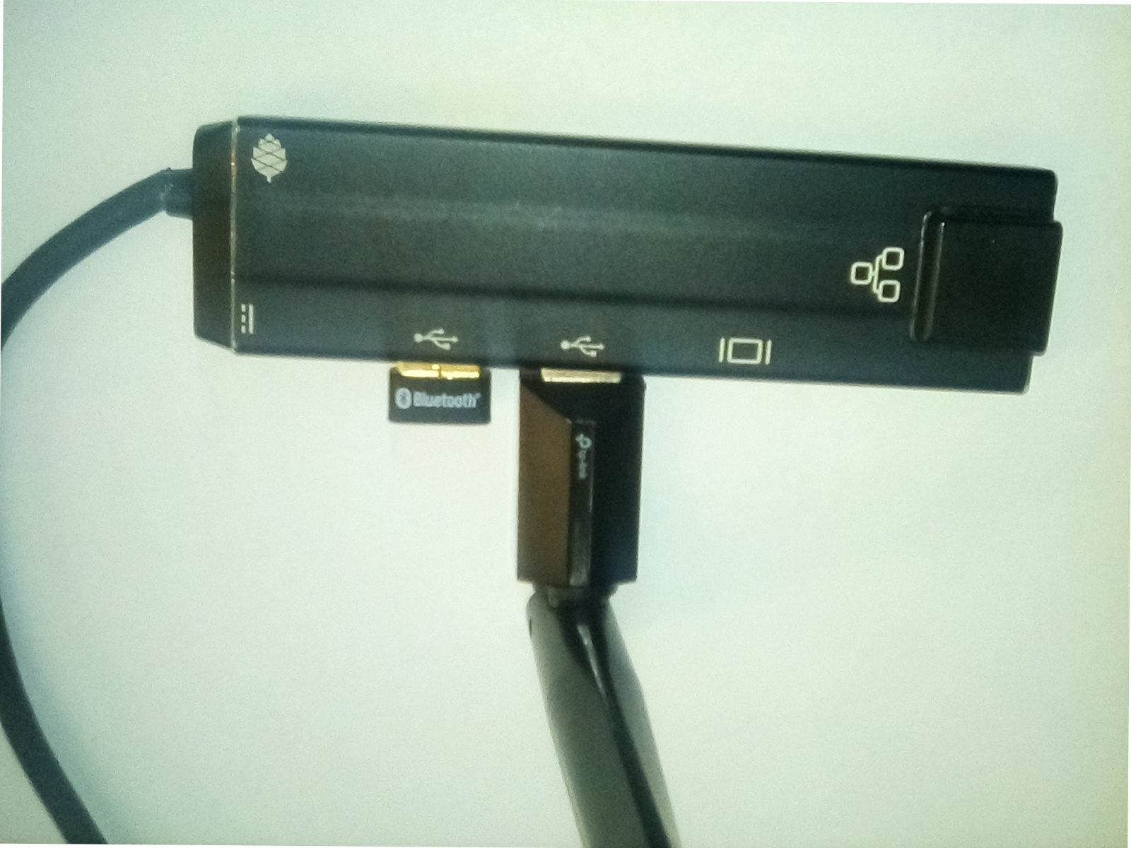

    The dock that shipped with the “Convergence package” of the original PinePhone works fine with the PT2 for WiFi & BT, with power connected; It has no problem with my JBL Clip & personal hot-spot (PP).
Make sure you have the right packages/modules loaded and everything connected before powering up your device.
Edit: to add pic
