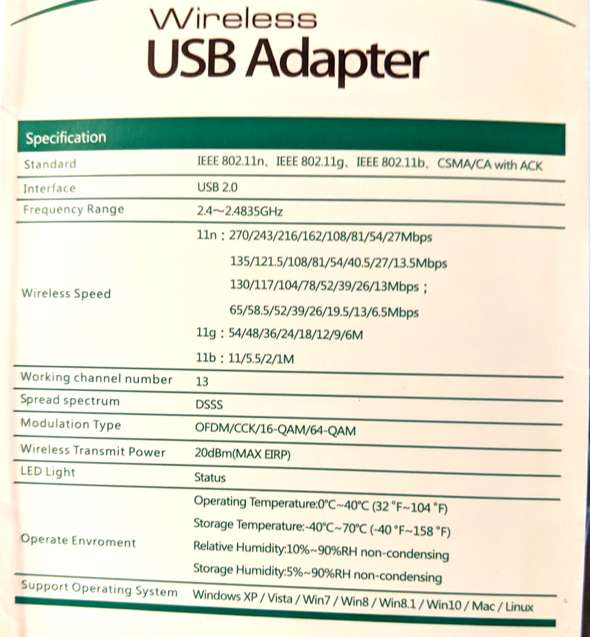

Mine arrived today and looks good but I was a bit surprised that the WiFi doesn't work and I cannot see a simple solution.
I have a cheap USB WiFi dongle which worked immediately, but having this hanging off the side with a USBC adaptor, is far from ideal. I'm looking forward to a simple (for me) driver download for the internal WiFi. B'tooth would be nice as well.
Edit: 3 days later, I am more and more impressed. I bought this to replace a broken Linux tablet but it is likely that it will replace my HP EliteBook i5 laptop, as well.
