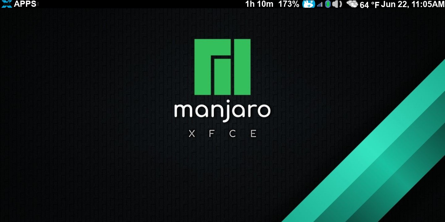

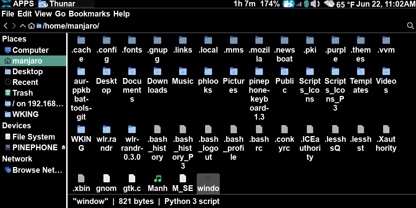

(06-21-2023, 05:27 PM)I was prepared to do a full reinstall of an OS that would take on xfce, but first I tried: Wrote:
sudo pacman -S xfce4 xfce4-goodies network-manager-applet onboard
Then:
sudo systemctl disable phosh
Upon reboot, xfce can come up as desktop. Initial rub: it boots to shell, so both user/password are necessary, followed by:
startxfce4
With handle-jiggling, xfce works (though not as a phone). Most vexing is the once-again failure of top keys (minus, underscore, etc). Workaround so far is a combination of xbindkeys and onboard keyboard, since in xbindkeys, pipe and backtick produce errors (eg:
xdotool type|
makes linux thinks there’s a script error).
To produce accurate battery percentage for combined phone+kb, I had to script a genmon applet. But tuptime also works in genmon.
I’ve keystroked all apps/utilities since touchscreen is hard to use for menus, etc, but phone+kb now looks like a laptop hit by a shrink ray and everything pretty much works.
