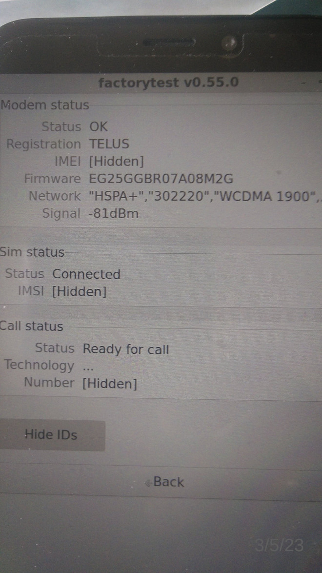

I can not make phone calls with this new PinePhone Beta convergence (3GB RAM). The phone establishes a 3G connection and I am able to send and receive text messages. Outgoing calls end immediately, incoming calls go to the voicemail at the network provider.
What I have tried:
1) 2 different SIM cards (both work fine on FP2 with UT and on an android phone)
2) 3 different distros, latest releases of Manjaro (Phosh), Mobian (Phosh) and PostmarketOS (Phosh) in combination wit both SIM cards. Presently Mobian with Kernel 6.1
3) I have run the Beta Edition factory test OS build from SD card and the modem Debugger shows no abnormalities (see attachment)
4) I tried to set network manually at 3G as in suggested in the previous thread.
5) Things work on my original PinePhone (UB Ports CE) .
Any suggestions how to investigate this further or what else to try ?
