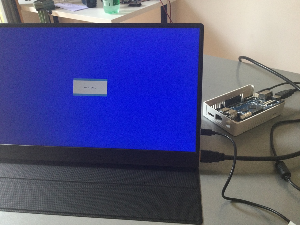

I hope you guys can help me get started on this one.
At the moment did the following and got stuck:
- Quartz model A board, with power and HDMI connected to external monitor
- Downloaded & Installed Balena Etcher in my Ubuntu
- Downloaded latest armbian image (Notice Armbian download link is broken on the Pine website)
https://armbian.hosthatch.com/archive/pineh64/archive/
Installed this on the EMMC card. Is there any switch to tell the board that needs to boot from the emmc or is automatic?
When I turn on the board, guess it's the Power button, do not get (so far anything) using HDMI.
Question: It would be really great to make a "getting started" section where is a bit more explained how to get started with this.
I know is only for developers, but developers don't necessarily need to be Rocket scientists to install Linux in a board Idea
Tried with Manjaro release:
https://github.com/manjaro-arm/quartz64-...g/20220606
and it seems HDMI works out of the box. Now next step is to connect a keyboard and try it out!
Maybe I just choosed the Armbian wrong distribution from the Archive? Or just one where the HDMI drivers are still not working.
One more recommendation: Can anyone tell me if there is a Linux distribution that I can install where it has already the Eink drivers?
Would like to connect an epaper and try it out.
Thanks a lot for your feedback.

I think you may have used the wrong Armbian images. From my investigation it uses quartz specific builds:
https://users.armbian.com/balbes150/quartz64/
I to just got my Quartz64 a few days ago, and are also a bit suprised at just how "developers only" it is.
And i have been flashing countless SBC boards for years of various kinds.
i tried the manual compiling of Arch linux from a guide on the Wiki, but the guide referenced gitlab CI artifacts that was expired and removed, and a few other things, and in the end i was not able to make it boot.
Today i will try to get Manjaro working, and then maybe detail a step by step guide and post it to the Wiki and in this forum.
No idea what kernel would allow for eink drivers sorry..
