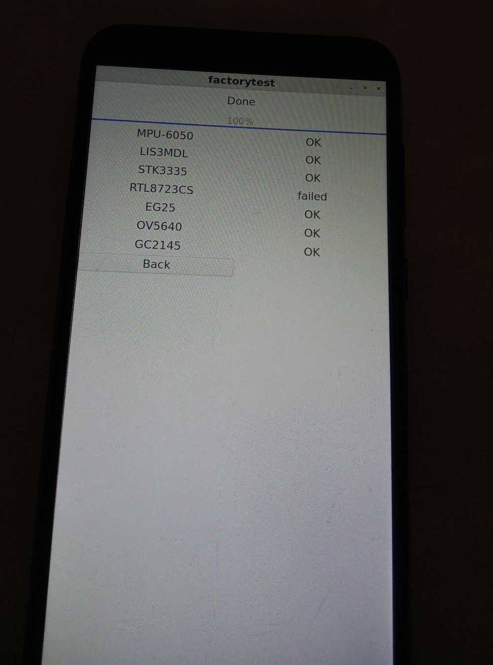

I have made yet another test with factory image. See attached picture.

  "The Android test image cannot run your wifi",  ===> that "could be"  a shortcoming of that OS ?  I have not tried that one.
    ( Is that Android test image for the original Pine phones ?)  ===> (maybe try the original Post Market test image ?)
My Brave Heart came with a custom Test OS from the people at Post Market.  ==> (That also installed some of the firmware ! )
