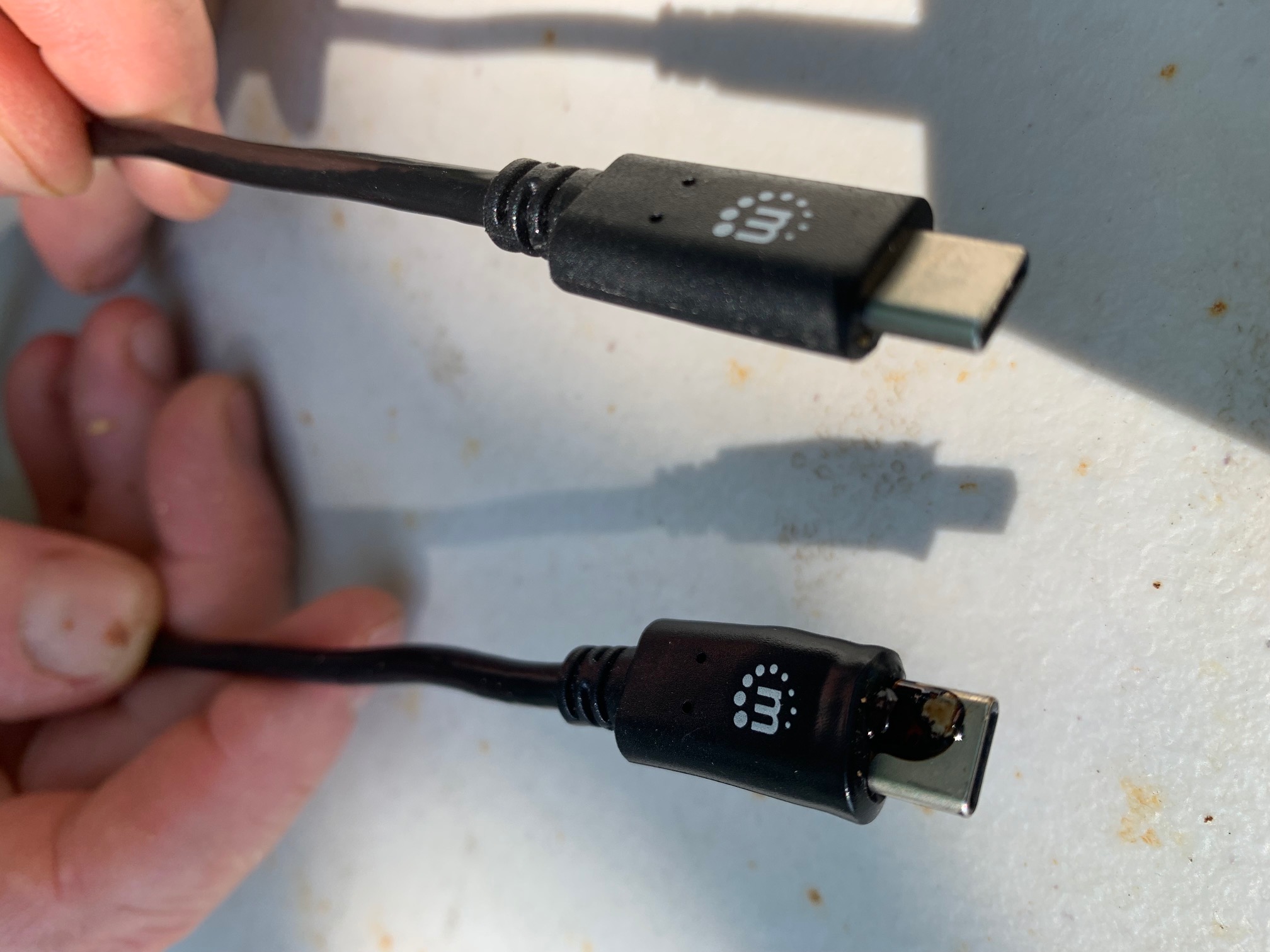

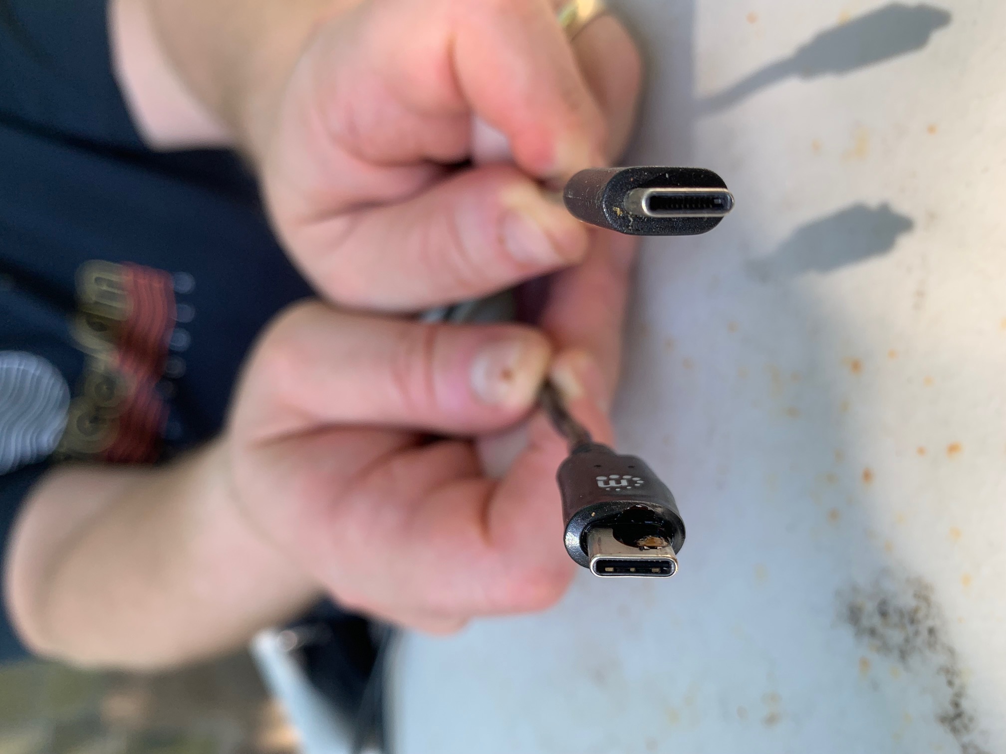

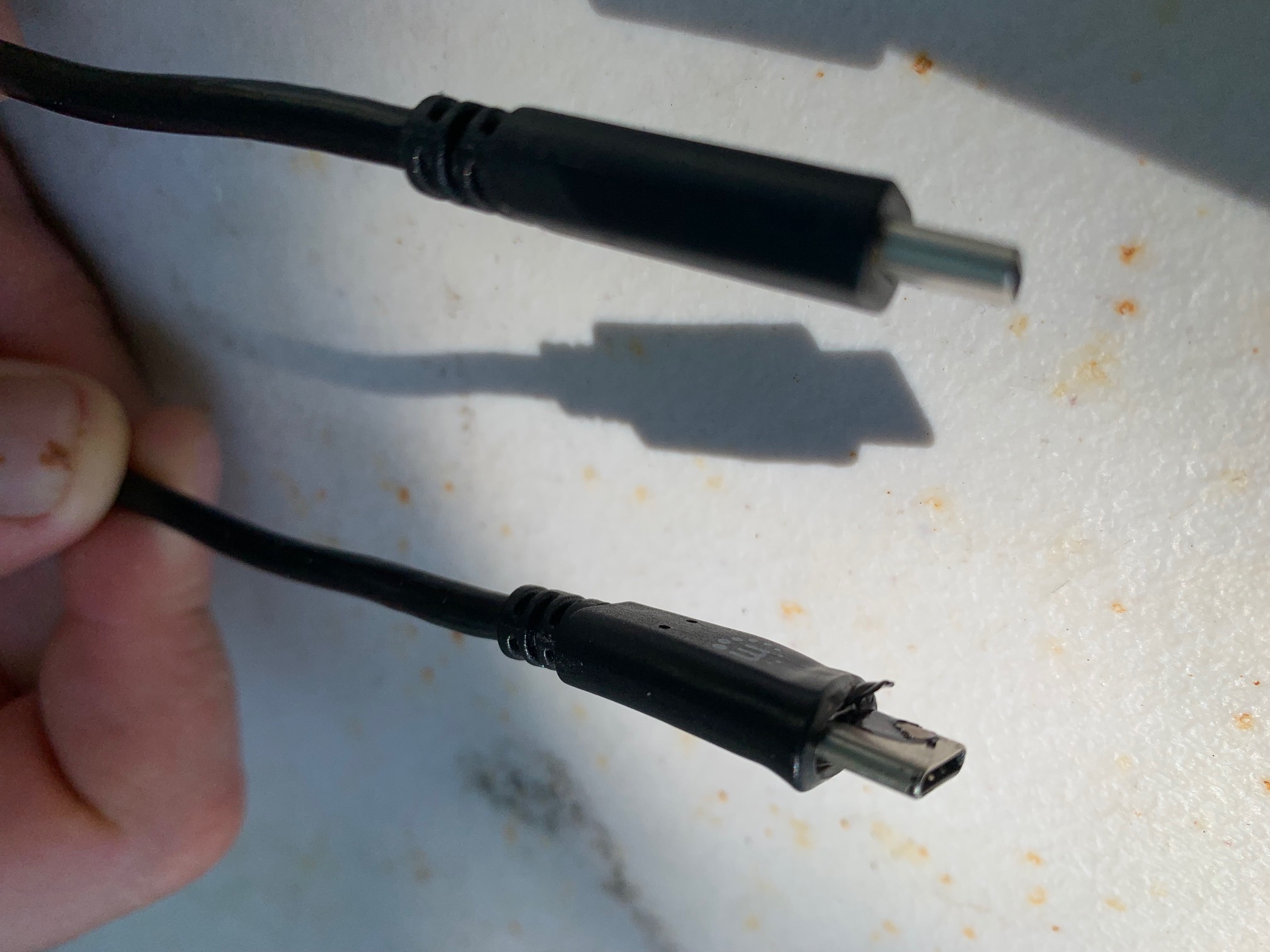

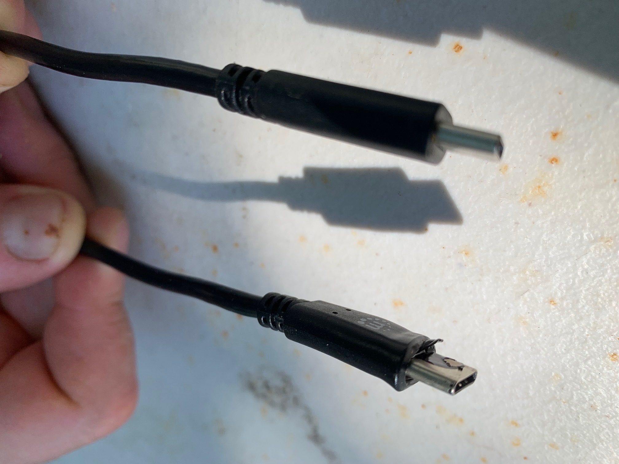

[quote pid="99074" dateline="1629512039"]
I was  using a  10' Manhattan  USB-A to USB-C  cord when  the overheat
occurred and the cord connector (USB-C) attached to the Pine64 melted.
I  took photos  of  the connector  that melted  next  to an  undamaged
connector by the same manufacturer.  The photos are attached below.  I
have never  had a problem  with a  Manhattan cord before.  I purchase
them because I trust the quality of their products.
I powered off the phone and  checked the battery.  There does not seem
to be  damage and there  is no smell  of burned components  within the
cell phone.  The battery appears to be undamaged.  There is no sign of
obvious deformation from heat damage.  I  moved the phone outside to a
safe, non-combustible location, plugged it into an extension cable via
a  3A charging  block and  the  red USB-C  cord with  which the  phone
shipped.  The phone again got significantly  hot, but the red cord was
not  damaged.  The  phone  has always  run  significantly hotter  than
typical Samsung or Apple cell phones  and I assumed that the model has
thermal problems  that need  to be worked  out.  Recently  though, the
thermal problems seem to  be worse.  I am using the  Pine64 as my only
cell phone.  I no longer  trust bringing the  phone into my  house to
charge at night as  my family sleeps.  I do need  a working, safe cell
phone.
Please see enclosed  melted connector shots.  The  Manhattan 10' cable
is no  longer safe  to use.  It had charged  the phone  regularly for
about 2 months.
Are  there critical  differences between  the red  USB cord  and other
manufacturer's  USB-C charging  cords?  Are  other manufacturer  cords
incompatible with the  Pine64?  Do all Pine64  phones have significant
thermal problems or is my particular phone unusual?
Thank you,
marc

To: support@pinemicrosystemsinc.zohosupport.comCc: info@fsf.org, info@consumer.orgSubject: Re: [## 10808 ## Wrote:  [Order #185614] (May 7, 2021) Phone bottom end got hot, plastic melted, fire concernReply-To: mronell@riseup.netDear Sirs, pid='99074' dateline='1629512039']
The attached  photos show two  different cables.  The melted one  is a
USB-C to  USB-A 10' cable  manufactured by Manhattan that  was damaged
while charging the Pine64 cellphone. The 2nd cable is another cable of
the same type shown only for  comparison. I am displaying an undamaged
cable  next to  the  cord  that was  damaged  while  plugged into  and
charging the Pine64 phone for contrast  so that the melt damage on the
wire used  to charge the  cell phone  is easy to  see. I have  not had
problems with  these cables in the  past; they have lasted  and served
well. The cell phone, on the other hand, gets inappropriately warm/hot
regularly. This is the first time the  cell phone became so hot that I
could  not handle  the phone  directly. I  do not  see heat  damage on
either the  cell phone or its  battery.  I have tested  the phone with
its red  cord, and  the phone still  turns on and  seems to  work, but
again  it is  hot.  I  am concerned  about  the  thermal heating  and
inappropriate temperatures  of the  Pine64 phone.  As a  free software
enthusiast, I was supportive of your  cell phone and your efforts, but
I am  worried about  the potential for  a fire at  this point  with at
least my particular Pine64 phone. I still want to see a free software,
configurable  phone, and  fundamental  privacy  features designed  and
maintained by the manufacturers.
I  recommend  you  cross-ship  me  a  new  phone  and  send  me
packaging/postage  to  return  the  device  that  seems  potentially
defective/dangerous so that you can adequately investigate the thermal
properties of the cell phone.
I  need a  workable,  safe  cell phone  solution.  This  phone was  my
full-time  cell phone.  I was  able to  use it  as a  cell phone  with
patience. I am now, unfortunately, working to find a safe substitute.
Marc D. Ronell
      phone (Home): (617) 332-5007
    address (Home): 45 Auburndale Ave
                    West Newton, MA 02465-1403
                    USA
              mail: mronell@riseup.net

phone got way too hot.  It has  always run very warm, but this was not
reasonable.  The  charging cord  end started to  melt.  Felt  like the
battery might enter thermal runaway.  I  believe that the phone is now
not safely  usable.  The phone  is still  running and has  cooled down
maybe, but I am  not sure whether there is lasting  damage and I don't
want my home and  family burned.  I have it now  outside on a concrete
patio surface.
Is  there a  warranty?  Am  I on  my own?  The cord  seemed OK  until
tonight.  Once it  melted, the cord now seems unsafe  as well.  I have
that unplugged also.  The cord was  by Manhattan, 10', USB-A to USB-C.
Charger  seems  OK.  We  have  other  similar  cords  in use  with  no
problems.
Marc

I wouldn't throw the blame on the user just yet. There's not much in the bottom part of the phone that should be getting hot (certainly not when no charging is going on!).
https://megous.com/dl/tmp/e05b1202e1a053c7.png
What should be getting hot down there? There's nothing there. It's just connector and some protection diodes, vibrator motor (but that one is not thermally connected to the type-C connector, so it would be hard for it to melt the USB-C cable), etc. It's some kind of problem with one of the connectors probably.
Measuring the USB-A side if there's a short or close to it there, might exclude it.
Imperfect connection (increased resistance of the contacts) or misalignment, or dirt might also cause heating of the connectors. Do the connectors lock completely, or is it a bit wiggly, or do the connectors separate easily? They should not.
(08-25-2021, 10:20 AM)bcnaz Wrote: Simple :
Your cord is much too long !
At 5 volts DC the voltage drop over long cords causes an over-current condition.
If you had the phone turned on, it was probably still discharging,  even with the charger plugged-in.
Too long, or not too good a cable would actually help reduce the power loss on the connector, because pinephone monitors the voltage drop, and if it gets bellow 4.5V on the phone side, it starts reducing current consumption. If you're unlucky and have a very good cable, but not so good contact in the connector, and lose 0.5V on the contact (worst case) and very little in the great cable itself, with 2A going through the connector, that's a whopping 1W being concentrated in the tiny connector. That will probably melt it over time.
"Bad cables" would have the power losses spread more throughout the cable.
my website: https://xnux.eu
I am having a similar issue. Just noticed before the cable melted.
@megous thanks for the hint of measuring the USB-A side. Indeed there is a short of the outer two pins (VCC and GND) which explains the effect.
I will order a replacement board and then unsolder and check the components connecting VCC and GND to see which one produces the short.
