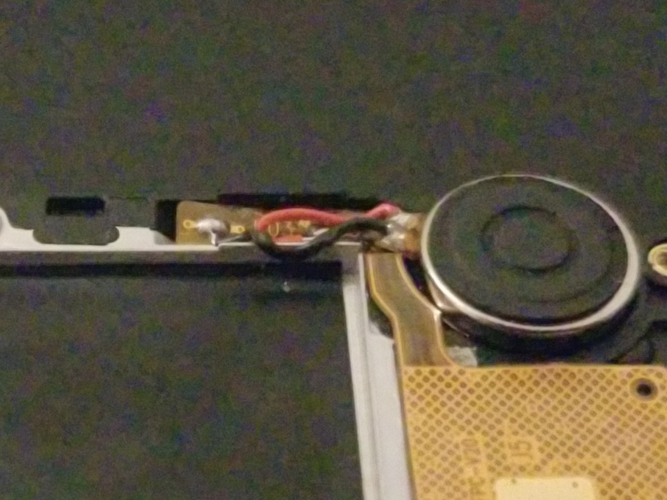

Recently I attempted a PinePhone screen repair and when I tried to power the phone on again the screen worked but the phone was constantly vibrating and wouldn't take charge, any ideas as to what the problem could be?
(03-23-2021, 05:52 AM)ncc Wrote: i read here somewhere that this may be caused by shorting the cable to the motor.. maybe you have squeezed the cable at the gap while closing the inner frame
What would the solution to that be? Do I have to replace any parts?
(03-23-2021, 06:47 AM)ncc Wrote: i would open the innerframe and look for a pinched cable..
How would I identify that sorry?
Please check the attached photo location for constant vibration. For no charge, possible the flex cable between USB-C side (daughter) board and mainboard doesn't snap in properly
