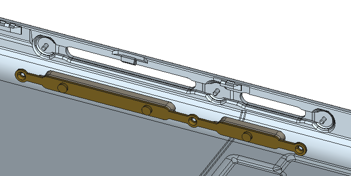

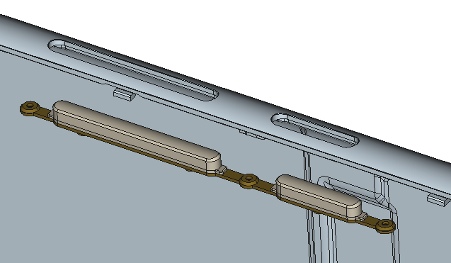

(03-27-2021, 06:35 AM)dgdimick Wrote: To answer the button question, yes, they just lay in the case, so every time you open the case your going to have to watch for them getting lost.
The buttons are fastened onto a thin long flexible strip. This strip seems to snap on three very tiny pins molded into the case. The strip and buttons may be salvageable, but I'm not sure how the pins to hold the strip in place would print out.

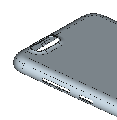

Another issue is that the area around the rear camera has a bulge, so the cover cannot be printed flat on the print bed. User sundog did manage to print it sideways, this might work. https://forum.pine64.org/showthread.php?tid=9188
The snap tabs all around the inner sides of the cover are very small, and the cover is very thin with variable thickness (more info on thread I linked). You may have to print this with very low layer height.
