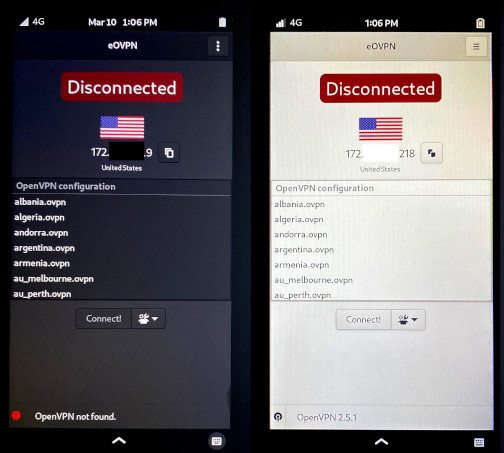

I have something I am trying to figure out and haven't been able to. I have a paid VPN service that uses the OpenVPN protocol. I have used it on the Pinephone on Arch and Manjaro but for some reason the eOVPN app cant see Open VPN is installed and up to date in Mobian and won't connect. See attached pictures. See the bottom line in the picture. Left Mobian-Right Arch. Anyone suggest anything?

Hmm, I can't say I ever used the gui eOVPN. Have you tried setting up openVPN through the commandline interface instead? Just try it with one servers openvpn configuration, to rule out if its the app or something else.

Thanks for the suggestion anyway. Yes it works through the command line but that's not a practical solution without being attached to a monitor, keyboard. When I need a a VPN I am usually traveling. Needs to work through the GUI in the long term but for now I am using the Proton VPN GUI which uses another protocol. It's the free version of their VPN and slow but a temporary fix till I can figure out.
Native or flatpak? The readme mentions the '--debug [LEVEL]' command line option or an environment variable to set, which is easy for a native install but I don't know how it works for flatpak.
https://github.com/jkotra/eOVPN
The code getting the version is here:
https://github.com/jkotra/eOVPN/blob/mas...openvpn.py
See get_version(self) at line 172. It's trying to run 'openvpn --version' and find the version in the output using a regular expression. Is it unable to run the command (no openvpn in the path, sandboxing preventing it running, something else?) or does the response not contain a matching string? Or is there some other problem like a missing python library that's getting hidden by error trapping?

Thanks, I have been through all the debugging. No joy. I gave up.  I purchased a subscription to ProtonVPN for a year to use on the Pinephone when I am running Mobian. That app is fairly new. I will pass that bug on to the developer and let him see if he can figure it out. Somehow the file system must be different although I couldn't find it or something is missing in Mobian. There are files for OpenVpn everywhere throughout the system.

from v0.20, eOVPN supports NetworkManager. for this to work, make sure you are using NetworkManager and has openvpn plugin installed.
sudo apt install network-manager-openvpn
sudo apt install network-manager-openvpn-gnome
then install eOVPN flaptak with --user option.
flatpak install --user flathub com.github.jkotra.eovpn
