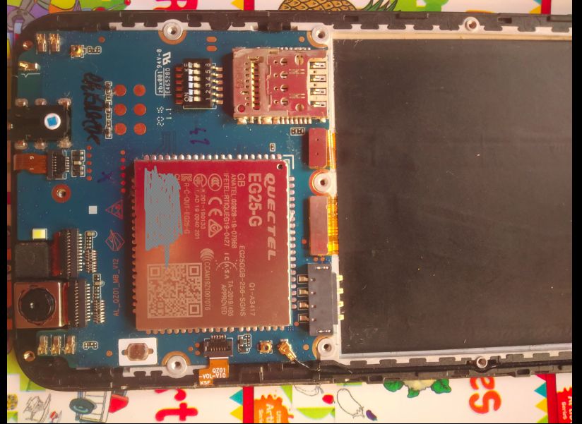

(12-05-2020, 10:45 AM)hiimtye Wrote: the BT/Wifi module is held on the board by a coaxial cable with no locking mechanism, have you verified that it hasn't simply become detached from the main board?
@hiimtye - Sorry for quite delayed response, I was using the phone with just mobile data. Today got some time, I have ripped open the phone. I have attached pic of the main board, all cables appear fine. Which co-axial are you referring here?
the cable that goes past the battery on the side
(01-14-2021, 10:31 PM)hiimtye Wrote: the cable that goes past the battery on the side
It appears fine. The wifi module is present on the main board right and not on PINEPHONE USB-C SIDE BOARD (chip which is at the bottom of the phone near the speaker) ?
If the wifi chip is dead, replacing the main board will help right to get the wifi working?
