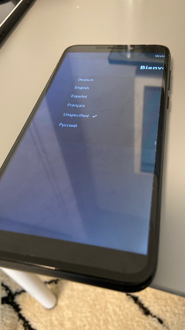

Unfortunately can't get past the initial screen... Sad

I have no idea why they removed screen auto rotation. Its in their comments so it was obviously intentional. Maybe that has something to do with your first language screen you are stuck on?
