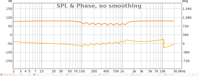

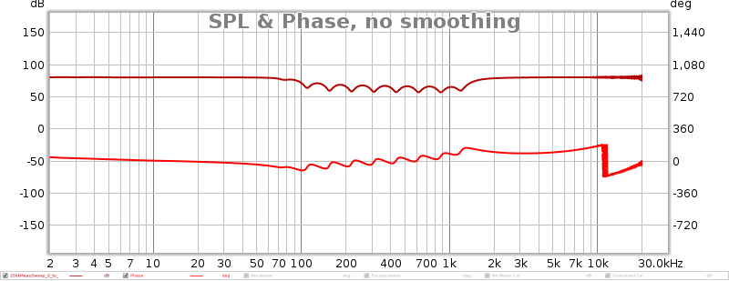

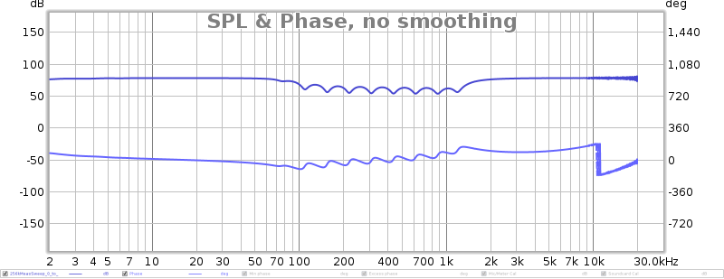

Alright, so I did some measurements with REW and they confirm my findings.
Here you can clearly see the dips in the 100-1k range and noise in the 10k-20k range. Phase looks all kinds of weird as well.
Not much difference with the headphone amplifier at -24dB.
This is where things get a bit interesting. Adjusting DA0 and DAC to -3dB produces significantly cleaner output in the 10k-20k band. There's still what looks like a phase inversion at 11k but the difference is actually audible (previous noise-shaped SPL deviance at the most extreme was about 8dB peak to peak).
What's slightly confusing though is that as far as I can tell the headphone amplifier, DA0 and DAC are entirely internal to the SoC with only the amp outputs being externally connected. I have no idea how to fix this without involving Allwinner so we're probably better off just sticking with the -3dB attenuation even on future designs.
Anyway the major dips are at 78, 110, 156, 220, 311, 440, 622, 880 and 1195 Hz. This definitely looks like harmonics to me.

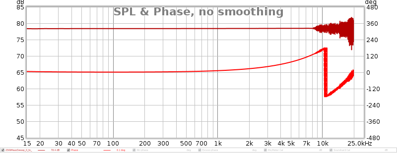

Edit: Further testing shows the noise in 10k-20k disappears at anything below unity gain for DA0, as illustrated below with -0.75dB gain.
Edit 2: These graphs are wrong, they illustrate a separate bug in Lollypop. The high freuency issues are still there and I'll post better graphs using mpv instead on Lollypop soon.

Can you redo the plots with a more useful scale please? Say between 0dB(FS) and -100? Same goes for phase - if you're using phase wrapping there's no need to go beyond +/-180
That response is just plain odd - as if there's an 8-band graphic eq in there with all bands set to -20dB or so. What load and sample rate were you using? There's no clear sign of a bass hump from interaction with output impedance, or an HF roll off from the series inductors, which were the worries as I understood them based on the schematic.

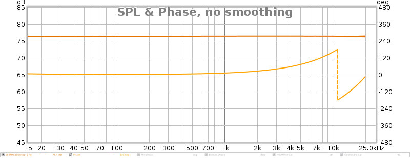

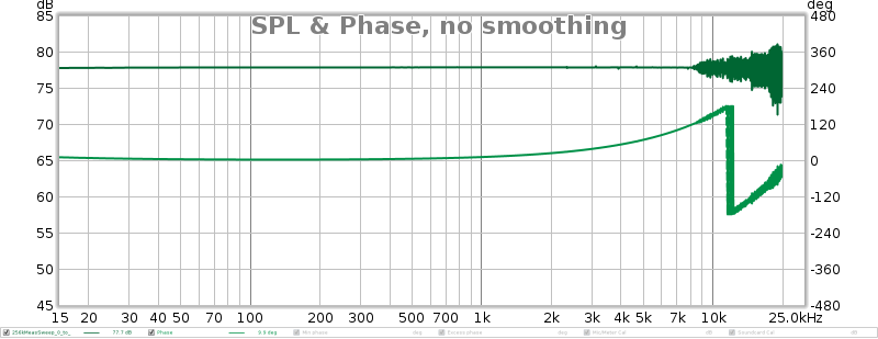

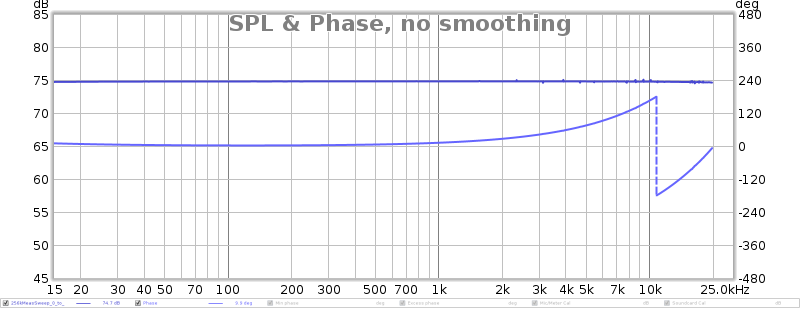

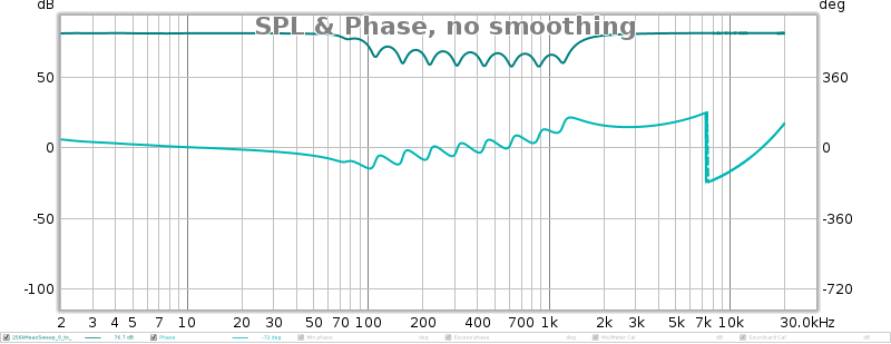

It turns out there's a bug in Lollypop affecting the frequency response. Please disregard the above ones and look at these instead (with hopefully more useful axis scales).
Massive distortion starts at about 8.5k and is clearly audible.
-24dB on the headphone amplifier doesn't make much of a difference (adjusted levels).
-24dB on the headphone amplifier in addition to -3dB on DA0 and DAC makes a huge difference.
Separate testing (earlier measurement so levels are slightly different) points to DA0 being the culprit. -3dB on DA0 alone makes the frequency response pretty much flat aside from the very high range above 15k and even then it's off by less than 1dB.
I think -3dB on DA0 is an acceptable workaround for the current hardware when used as a line out. I have yet to test this under any significant load so the dynamics with actual headphones attached are still unknown.

That's much more reasonable, and thanks for the effort. It's not exactly unknown for DACs to misbehave with 0dB(FS) signals so that may be what's happening here. Please post sufficient info on test method and settings for others to reproduce your results.
Edit: and what load is this into?
