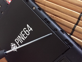

Well, I solved the problem.  In the process of taking the phone apart, I left it plugged in while it was constantly vibrating.  At the point of removing all of the small screws, it stopped vibrating while it was still turned on.  It continued to stay off so I slowly replaced screws until it started back up again.  I was able to replace all but one screw in the back and keep it from vibrating.  I did not have to cut any wires or any other modification but the screw.  As I tried to replace the last screw, I just started the screw and it would start vibrating again so I'm leaving that one out.  So far, so good and its working normally.....knock on wood.  The screw I left out was the one up from the bottom right corner as you look at it from the opened back. I attached a photo of the screw I left out.

Looks like the screw hole close to the Vibrator wiring. My guess the screw may shot one vibrator contact point and cause the vibration.

Thanks, I have a similar issue. Removing the screw made the constant vibrating stop but only for a few minutes. I tried to remove all the screws while keeping it on and vibrating stopped periodically but then started again and now it it back to constantly vibrating. Any other ideas for how to stop the constant vibrating?
