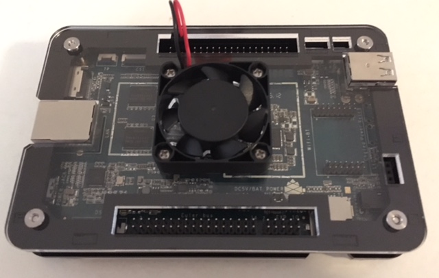

I have the standard Zebra slim case and it looks great. Maybe took 15 or 20 minutes, half of the time peeling the protective paper off the parts (not a big deal, just noting that the actual assembly is easy) - everything fits perfectly and i assume this is laser cut.
Only gripe is that the board is a little loose in the case. I don't think it would cause an issue except perhaps in high-vibration environments but it would be nice to have some bushings on top of the board similar to the ones under it but larger and hopefully the right size to keep the board from the slight wiggling it does.
I was afraid my fan was DOA as I apparently used the wrong pins. Went to page 2 as per Dustin's suggestion in the last post and tried it and the fan spun right up. Very quiet and while it is not super powerful it is probably more than adequate especially with that cute little heatsink that came with the kit.
I will be getting more c4labs stuff in the future, I predict. dunno if I'll get another pine64, sopine, rock64, or what but I don't see not wanting one of these cases unless I am trying to purpose build something waterproof or the like.

After a week I definitely notice the fan sound a bit more, but that's only if the TV and A/C are off. It's quieter than both, and my guess is it isn't necessary to function though I will probably try to stress test the PINE64 to see if I can get it hot enough to be a concern. Still very happy- it is attractive, affordable and pretty easy to assemble. As I'm starting to get hooked on these PINE devices, I could see getting more of these cases in the future.

Are you running the fan at full speed ?
... if you drive the fan via 2N2222 transistor using a pwm signal ( 5v switched on|off with a duty cycle of 80% ) the fan will spin slower and almost completely silently;  I wrote a script ( python ) which does this with software pwm , and has a mechanism ( signals ) that allow switching the motor between high and low speed under program control;  if it gets above a certain temp, or if you just want to, the fan can be switched to high speed for a while.
