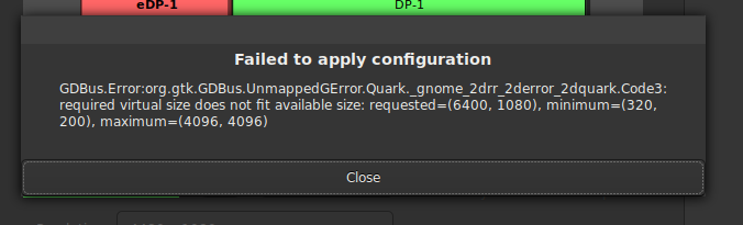

If I do choose to set the resolution I get the following error (cant copy it, have uploaded a screenshot of the dialog Screen3).
After that the screen goes dark, and if I go into the display settings dialog again the monitor is "flipped" off, and after turning it on again on the panel in the dialog I now have a bunch of sub 1920x1080 resolutions which were not there before (only the 1920x1080). I tried adding the mode with xrandr with 60hz, but it made no difference.

$ sudo xrandr --output "DP-1" --mode "2560x1080_60.00" --rotate normal
xrandr: screen cannot be larger than 4096x4096 (desired size 4480x1080)
Last time I checked 4096x4096 is smaller than 2560x1080 Smile so I have no idea what thats about.
4480x1080 is completely wrong resolution for my screen, but none the less I tried setting it. This actually adds the screen as "normal" and not counterclockwise, but gives me error of "screen4" attached file.
If anyone else has any ideas on how to proceed, I'm all ears.

@GloriousCoffee, looking at the math, if we add up your built in screen and external screen horizantal sizes, 1920 + 2560 = 4480.
I sumrise from this, that it's not possible to use a combonation of screen sizes greater than 4096 in either X or Y directions. So if your built in display is 1920 across, (which it is for our Pinebook Pros), and you want to use an external display that is 2560 across, it's not supported by the graphics in the Pinebook Pro.
Remember, the SoC is not a high end one, and neither is the built in graphics.
That said, it may be possible to treat your second monitor as a independant X-Windows display. Thus, having it's own 4096 x 4096 limit. It would not allow drag and drop between monitors. I've used such before, but not recently.

I wouldn' t blame it on the SoC.
I have connected a Samsung Chromebook Plus with the same SoC to a 4K TV with the screen on the Chromebook active and that worked fine.
And I assume it really was in 4K, as the mouse pointer felt like moving very slow, as 4K is much more surface.
The limitation is in the software, not the hardware.

I didn't even think of it as adding the two widths together, but that makes total sense now. Thank you.
By independent X-Window display, do you mean that the PBP screen would be turned off and the 21:9 monitor would act as the "main" screen instead of the PBP screen? If that is the case, I would be very interested to see if there is a solution for it.

@GloriousCoffee, in the case of independant displays, it's possible that both would be on. When you launch a program, it would default to the :0 display. And you would manually select launching a program on to the :1 display. Hard to explain except with shell commands;
DISPLAY=:1 libreoffice &
DISPLAY=:0 firefox &
It may be @jiyong is correct, the 4096 x 4096 apparent limitation may be a software limit. Quite reasonable for a laptop, until you add in an external display.
Anyway, I don't know the answer to this issue.
