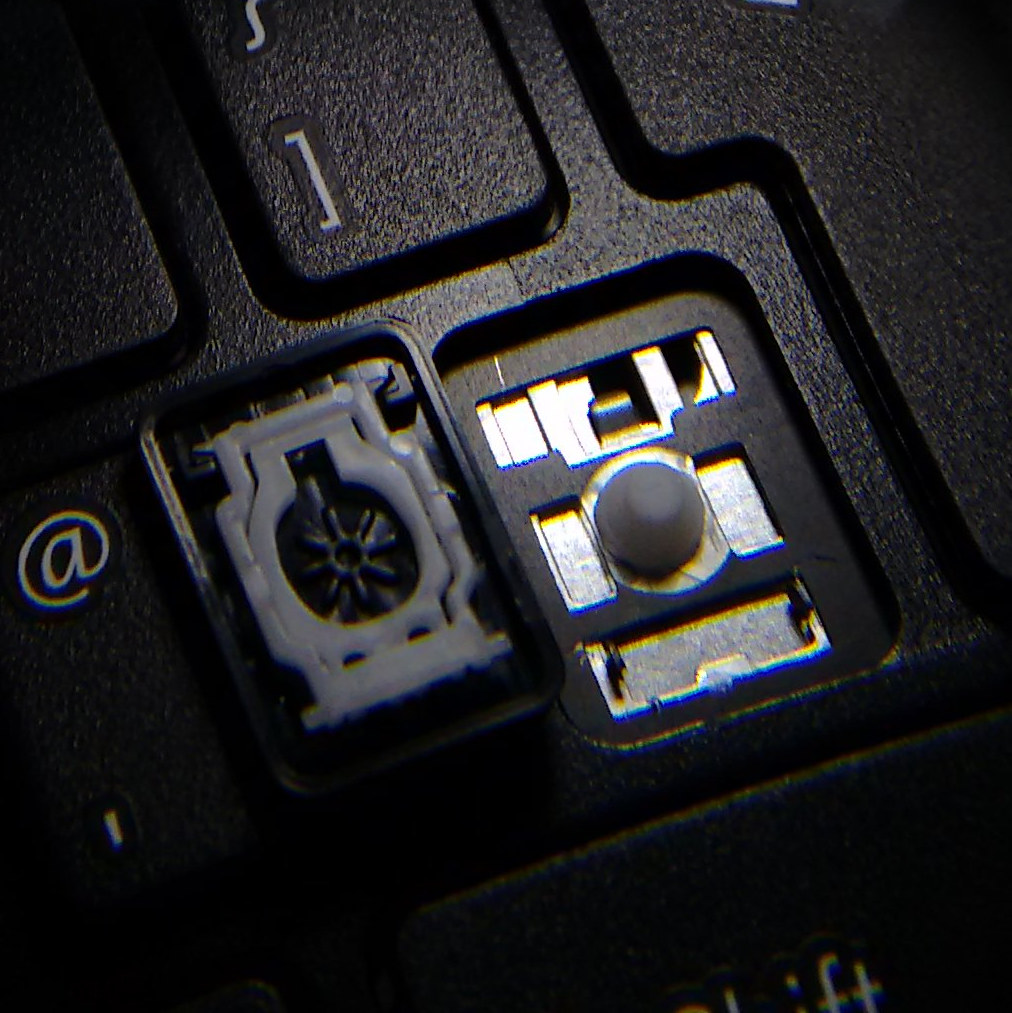

I have just one issue that's a show-stopper:  A key cap (or is it 'keycap'?) has fallen off, for no obvious reason, and I can't work out how to refit it. It's not had much use and I'm not a keyboard thumper, so it's a bit disappointing, but enough moaning - how do I get it back in place?
The scissor-type mechanism is still attached to the underside of the key cap (see attached image), and I can see that a part of it must slide under a metal hook-type piece on the keyboard... but I can't figure out how to manage that.

If you can't put it back (I only did that once and could press it right back down) make a support ticket...
@Bicko
Based on your message and the picture you attached, the plastic hinge is still attached to the key cap.
Using this reference:
https://www.computerhope.com/issues/ch001244.htm
It looks like the plastic hinge should carefully removed from the key cap, then installed onto the keyboard. The face of the hinge you see on the key cap would be the face attaching to the keyboard.
It looks like the bottom piece of the hinge fits under the hooks, while the top slot would side under that curved flat spring above the rubber cup.
Then once that is attached, you should be able to reattach the key cap by putting the cap onto the hinge assembly and pressing down evenly on all four corners of the key cap.
Good luck!

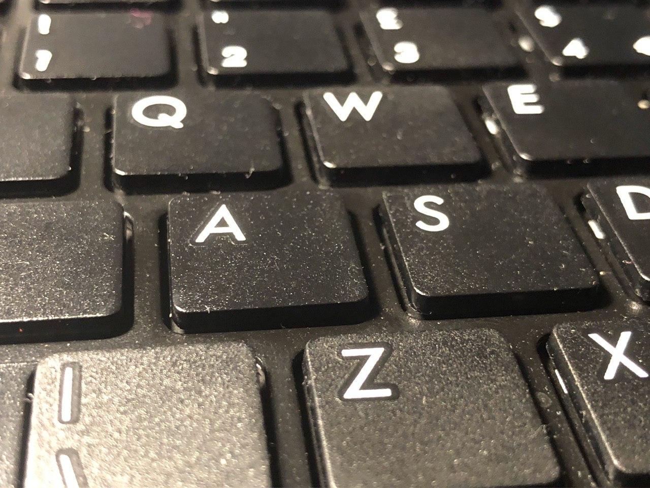

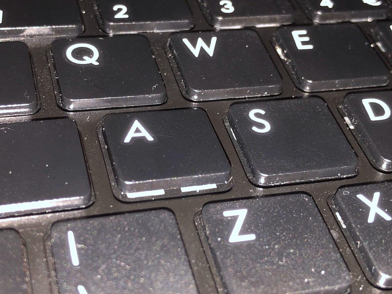

I have the same problem with key "A" I can out bck in but it it a bit loose and pops out after a couple of presses.
(11-20-2019, 06:11 AM)bolinches Wrote: I have the same problem with key "A" I can out bck in but it it a bit loose and pops out after a couple of presses.
Is the plastic hinge attached to the key cap when it pops off like OP? If so, you can attempt the suggested solution above. If not, I would encourage you to follow xalius's advice and open a support ticket.

Not ideal, I agree. I opened a ticket. First answer is that I try to re-attach with some angle, I will follow the process (which I tried multiple times before that answer from support) and lets see how it goes.

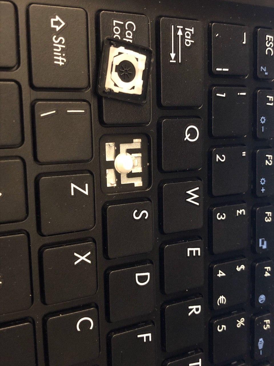

After some back and forth on the ticket, I got a nice video https://vimeo.com/97180298
While I was doing that I noticed that the two little pins on the bottom were loose in my laptop .... I little it of bit of carefully bending and .... fixed.
