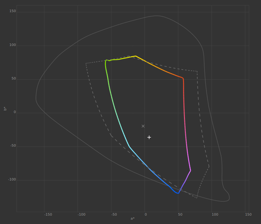

Turns out I had a Spyder 4 Pro...newer than I thought...still old though.  I am running Displaycal as I type this on my other machine.  As of this moment it is 1:02:34 into the process and 340 of 391 run.  When complete I will post profile.
Awesome stuff!
.png   Gamut.png (Size: 214.47 KB / Downloads: 870) I have the archive with the .icc profile that Argyll/DispalyCAL created for me...but it is slightly too large to attach...I will just attach the .icc for now and some screens.  In a rush and the icc has a crazy long name...probably want to rename it.
OK, I'm back home and tried to use xcalib to load the profile and I get "unsupported ramp size 0" errors but dispwin -v Pinebook.icc (this is the name of the profile I created) seems to work.   I say "seems" because I do not see a screen change in color or temp or anything else.  Dispwin -V Pinebook.icc seems to verify it is loaded....   I just don't know.
Anybody else try it?
.png   ToneCurve.png (Size: 180.95 KB / Downloads: 746)
.png   Gamut Screen 1 #1 2019-11-24 08-01 2.2 F-S XYZLUT+MTX.png (Size: 46.69 KB / Downloads: 716)
.gz   Screen 1 #1 2019-11-24 08-01 2.2 F-S XYZLUT+MTX.icc.tar.gz (Size: 672.41 KB / Downloads: 723)
