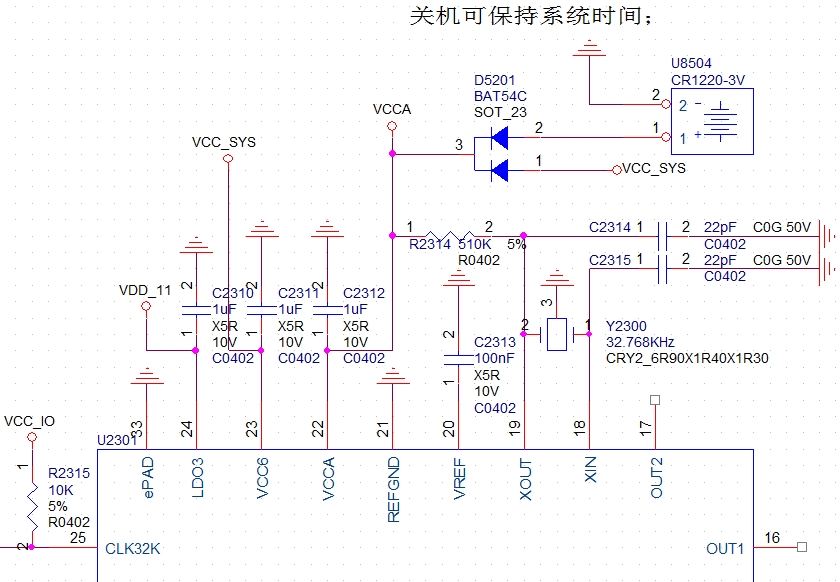

Attached is the RTC Battery connection circuit, some modification to board is needed.
