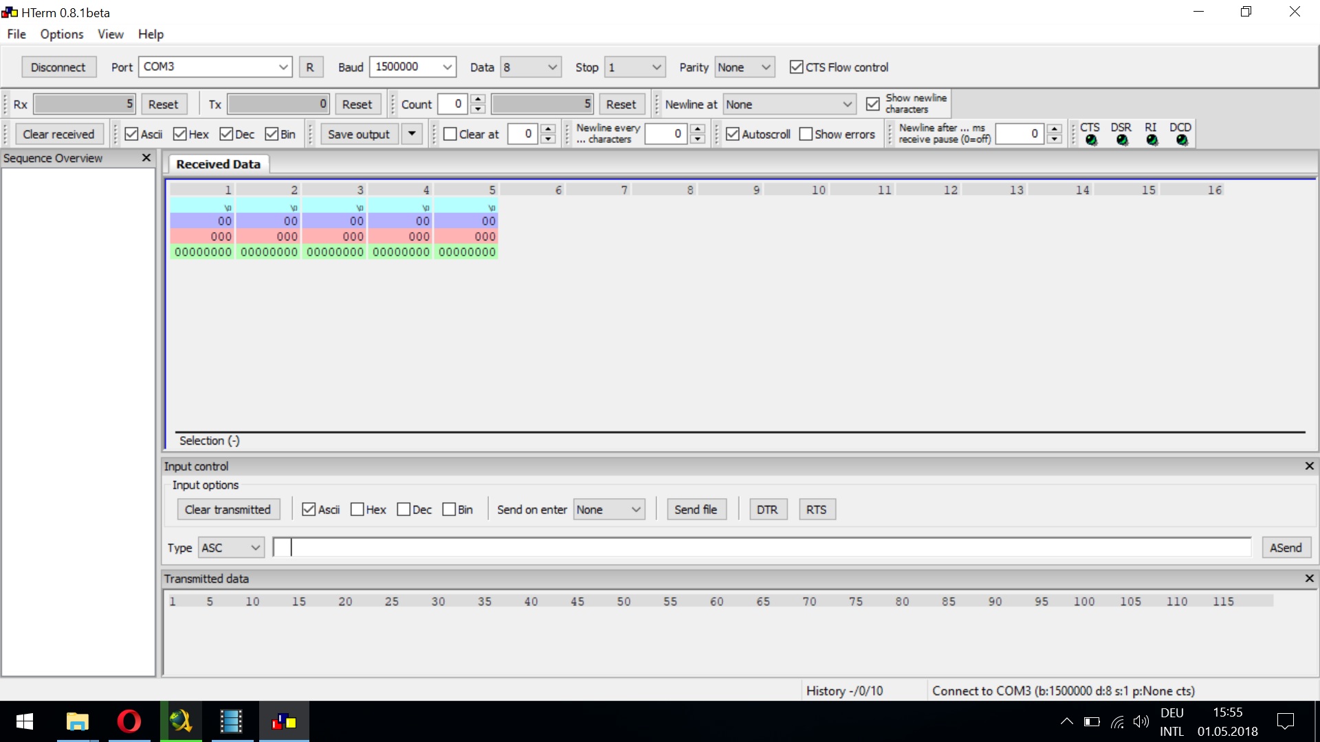

Have flashed again the spi flash on a SD card. SD card put in, rock turned on. After 5 minutes still no flashing, all 3 LEDs are lit continuously. Also over the serial console with activated FlowControll no improvement. (See the screenshot)
I have no idea what to do anymore.

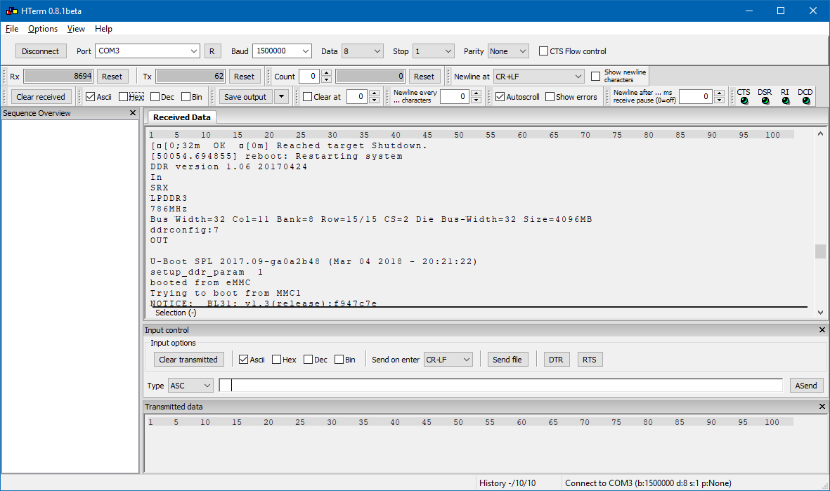

Ok, from the looks of the screenshot, on HTerm, you need to leave the flow control checkbox off, as it's CTS (hardware) flow control, not software flow control.
I'll run it up on my machine and see if there is anything else that needs changing...

So, these are working settings with hterm and the rock64...
I set the port, set baud rate (that was... awkward... control kept losing focus).... changed 'newline at' to CR+LF for both RX and TX, unticked show newline characters and that was about it.
