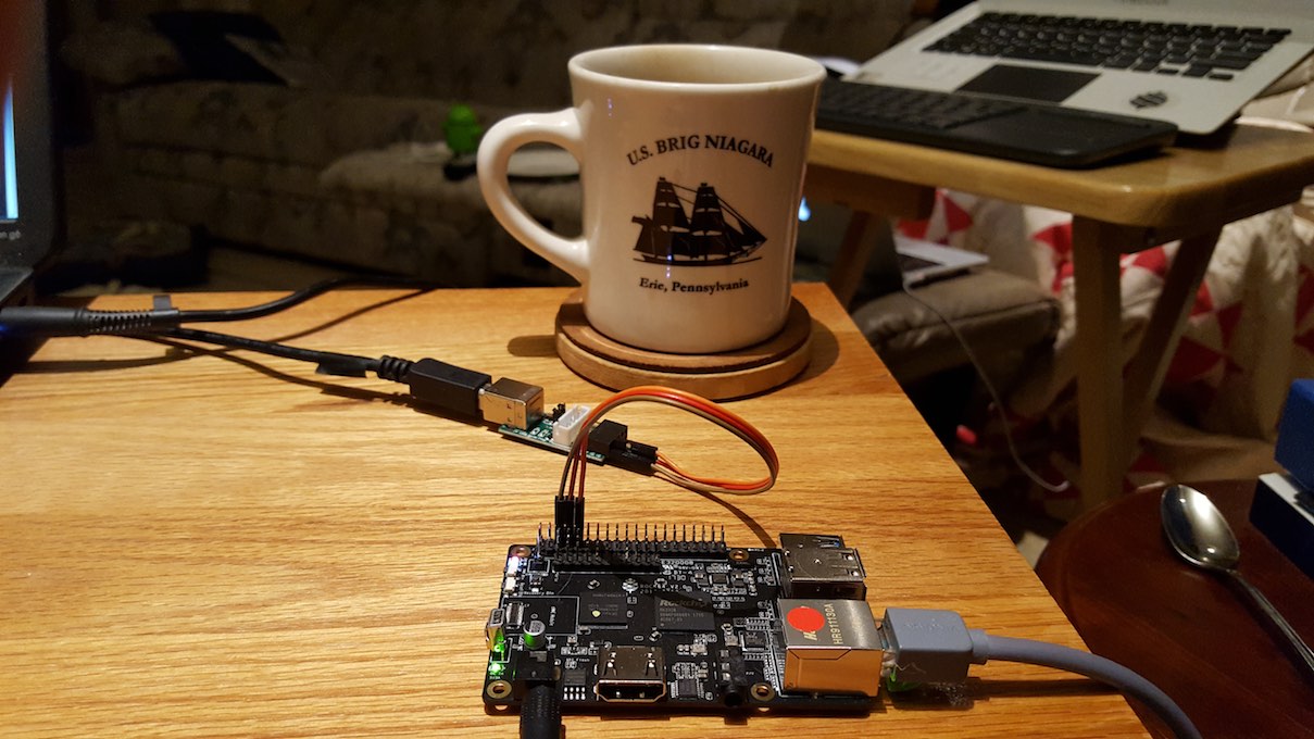

The new Rock64 is running sweet !
... just doing burn-in now;  got some python procs running;  ssh terminal stuff;  network and serial console right now, very pleased -- second Rock64 and many more to come.
Note:   very interesting;  unlike my pre release board, this production board (running the same image) is running much cooler;  the cpu|gpu is cool to the touch, and the temps idling are in the high 30s ℃  ;  loading the system with my PI routines drove the temps up to high 40s ℃ , and this without even a passive heatsink !

I got the M3 mounting hardware today;  typically I use M3 metric machine screws to mount my boards ( cased or not ) with a double set of washers|locknuts to adjust for height ( in and out of the case );   when not cased the M3 bolts make very nice stands|legs and since they are connected to ground 'bleed' very well to static desktops, mats, etc.
If you use this technique be careful because some of the components are very close to the mounts!  Also, the holes on the Rock64 board are too small for M3 bolts ( just barely ).  If you're careful, you can gently 'machine tap' them in with a hand driver and the legs are then very firm;  frankly,  the washers and nuts are not even required if all you want are legs !
