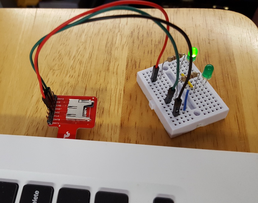

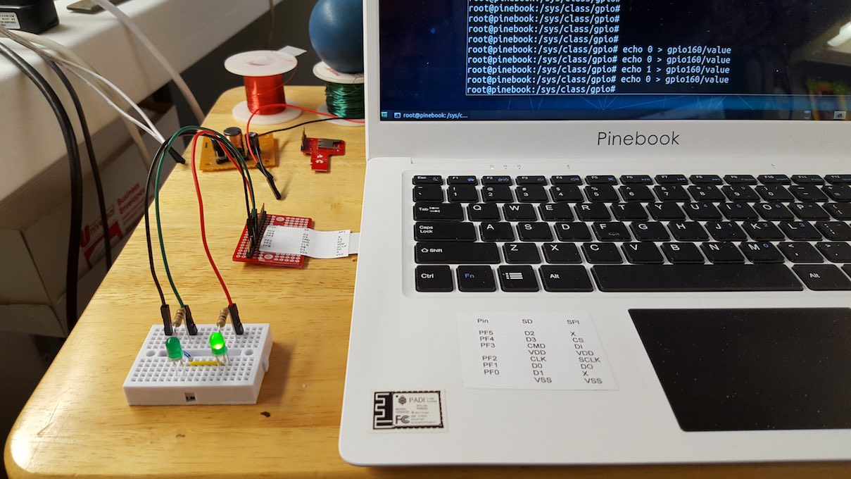

This is my first experiment with bringing some of the A64 gpio mux lines to the outside via the SD card slot;  SDIO.  These are data lines D0-D3, CMD, CLK, VDD, & VSS.  The lines are gpio160 - gpio166;  PF0 - PF6.
The pic above is the 48cm ribbon cable that extends the SD micro slot to a full size card adapter;  this ribbon is useful in itself;  but I plan to modify it for pin access on a solderable bread-board.
These two shots are the modified ribbon cable;  this was actually easier than I expected.  The cable will extend under the notebook.
The two shots above show the finished cable running;  I have the green and red LED(s) initially connected to CMD and CLK.  These are pulsing at regular 3/4 second intervals (or so).  The gpio(s) are not useful in this state;  next I need to hack the dts and make sure that the pin function register has '0' s.

(07-20-2017, 04:56 PM)MarkHaysHarris777 Wrote: This is my first experiment with bringing some of the A64 gpio mux lines to the outside via the SD card slot;  SDIO.  These are data lines D0-D3, CMD, CLK, VDD, & VSS.  The lines are gpio160 - gpio166;  PF0 - PF6.
Stay tuned.

This post is just to document the placement of the pins on my breakout with the extender;  the Sparkfun breakout board ( coming soon ) has a slightly different layout.
Pin     SD      SPI
PF5     D2      X
PF4     D3      CS
PF3     CMD     DI
+       VDD     VDD
PF2     CLK     SCLK
PF1     D0      DO
PF0     D1      X
-       VSS     VSS
Note:  Vss in the pic above (ground) is normally the third pin up from the bottom, between D0 and CLK.  I moved Vss physically to create two logical groups of three pins PF0-2 and PF3-5;  this also allows for good separation between Vdd and Vss.
Note:  See schematic pp 9;  T-card/USB
The above pics are option (2);  the model from Sparkfun is a little more expensive, but arrived in two days.  The Chinese version will be here in 30 days from Shenzhen (if I'm lucky with customs).  These plug directly into the micro SD slot (although its a little tricky, I did have to use the dremel tool).  The layout is similar but different; in this model the Vss and Vdd are together in the center.
Again, we have tapped the gpio(s) after mounting header pins on the sniffer card;  the sniffer card is designed to be a logic test point for logic analyzer.  I won't be pushing an SD card in the slot but will experiment with the gpio(s) using this direct interface.
Note:  pin (CD) is card-detect ;  also  D3.
By disabling the sdmmc for sdc0,  and setting sdc0 to function gpio_in, muxsel 0x0, drive 0x0, (pinctrl and bindings) I have been able to set gpio160 - gpio165 ( PF0 - PF5 ) to ON | OFF with the sysfs method:
echo 160 > export
echo out > gpio160/direction
echo 1 > gpio160/value
echo 0 > gpio160/value
After bootup the gpio(s) were in default input (cmd and clk no longer strobing); all six gpio(s) were successfully exported, defined, and set ON|OFF. In the left pic above the right LED is Vdd monitor while the left LED is monitoring gpio160 which has just been set ON.  In the right pic the gpio160 has been set OFF;  Vdd still indicating 3v3 rail.
Note:  the dts|dtb is static atm;  will want to configure so that uEnv.txt controls dtb "on-the-fly" via variable.
Note:  the SD card slot can be raw gpio(s) ;  or SD card external storage ; or SPI  (jtag, other)
Note:  All of this assumes ofc that the pinebook is booted via eMMC;  SD card slot is disabled for external storage
