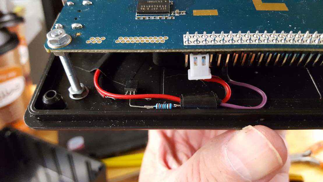

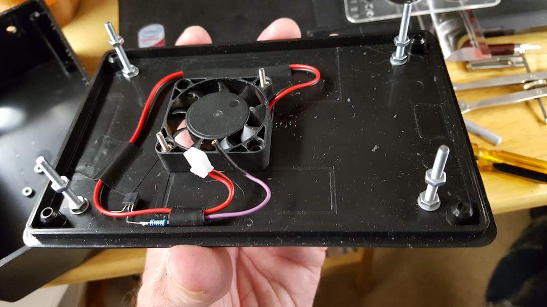

I began casing my ubuntu PineA64 board(B) tonight using the Radio Shack ABS enclosure;  in the pic above I have chosen to use the optional ABS plastic lid and have begun to install the board mounting hardware and the 5v brushless fan which will be employed to keep things very cool indeed.
You will note the 3M x30mm bolts are the same ones that it has stood upon for weeks now; also, note the transistor (2N2222) motor speed controller hardware, fastened to the top panel with electrical tape.
I used a blob of fast dry modeling glue on each fan mount; to keep the nuts from coming loose and dropping down on the pine board. The PineA64 board(B) will hang from its mounting hardware with the power filter and battery in the bottom enclosure and all cables running out the rear bezel.
The close-in above details the mounting hardware and the fan motor-speed controller circuit connections.

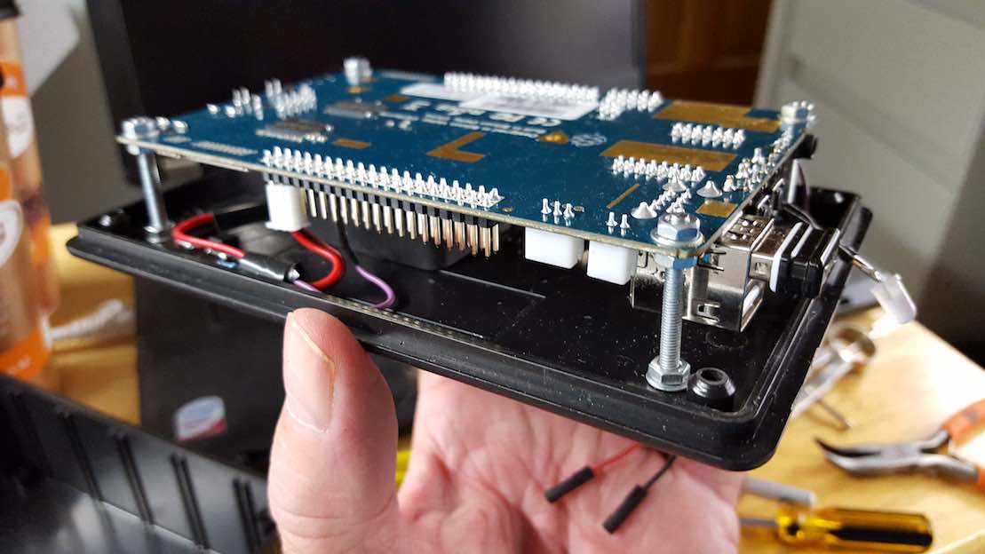

When the 'lid bezel' is inverted the assembly will drop into the bottom ABS enclosure. Note the system LED which will protrude through the front bottom enclosure bezel. The board sits about two-thirds of the way into the bottom enclosure allowing space for the power passive filter, wiring, and connectors.

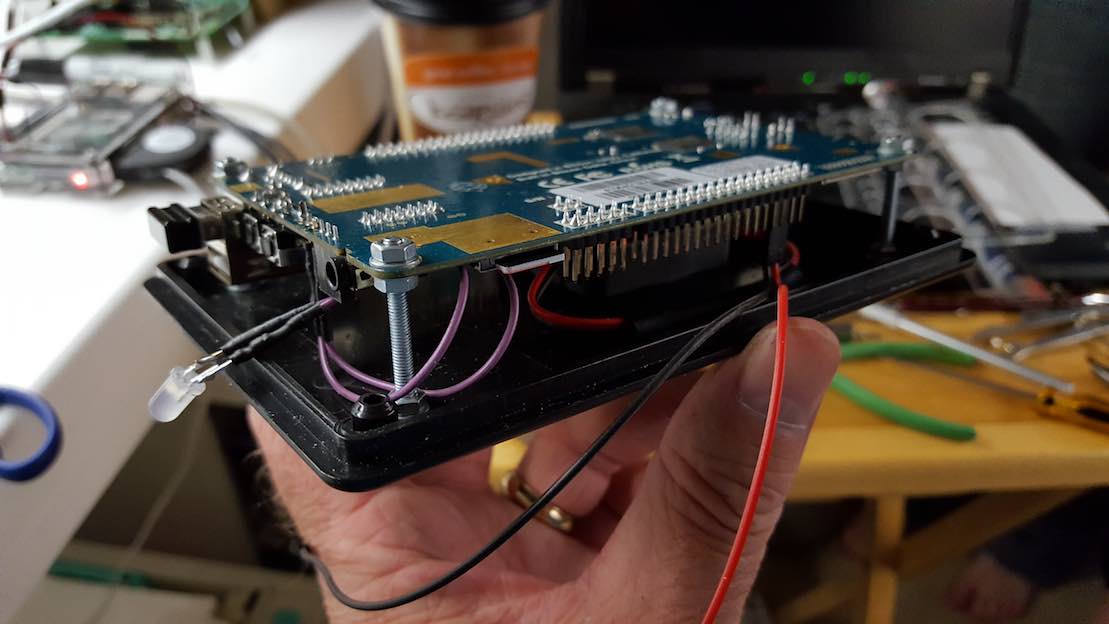

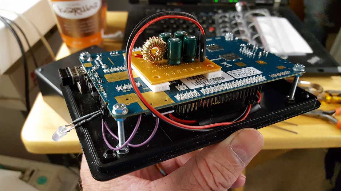

Looking at the other side of the top bezel assembly, I'm preparing here to mount the power filter assembly ; the red and black leads are the power leads coming from the euler bus pin(4 5v+) and pin(6 ground). The system LED (on male-female jumper leads--purple) will protrude through the bottom front bezel, as will the usb0 keyboard|trackpad receiver.
At some point (not now) I will cut an opening in the bottom section for easy removal of the SD card.  For now, its locked in place-- I actually remembered to insert it prior to assembling the prototype the first time !
From this vantage point the in-line passive low-pass power filter is clearly seen. The filter is mounted on a type of plastic velcro (no fabric is involved).  The filter is 'stuck' to the pine board and hangs downward with the rest of the top bezel assembly. The euler bus power connectors are in-place and we're just about ready to drop the top assembly into the bottom ABS section.

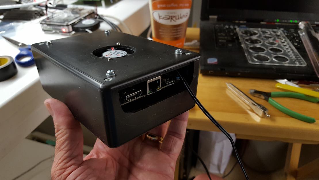

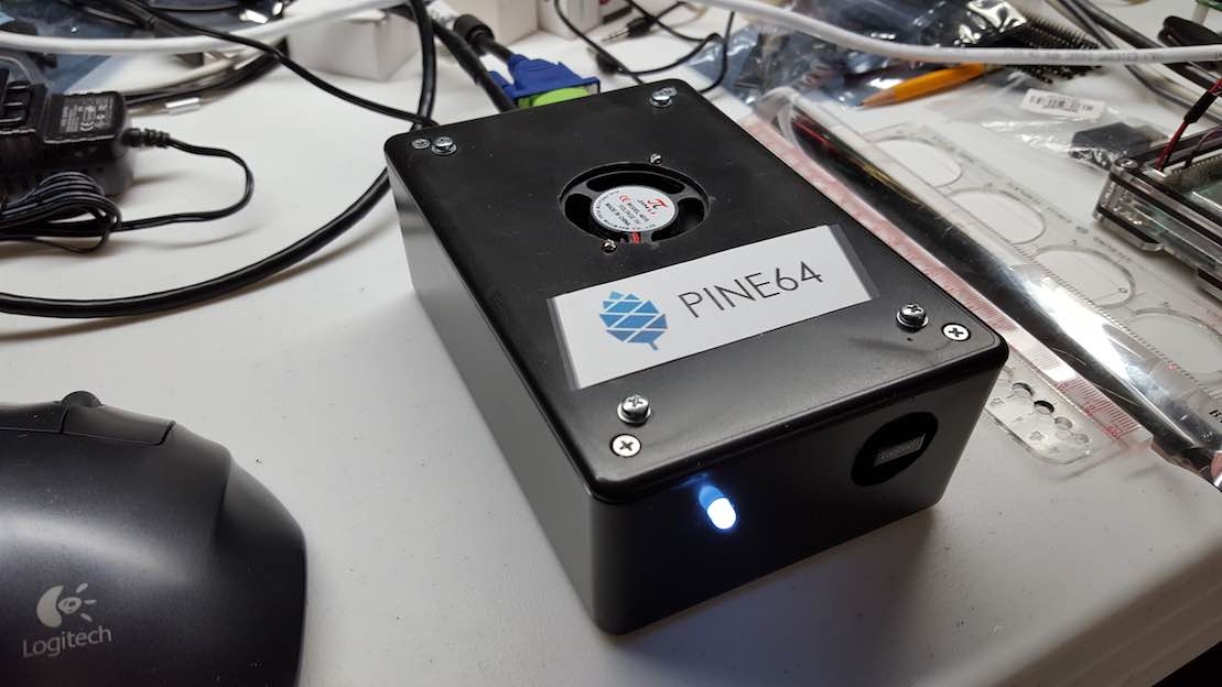

This is the rear view (obviously) of the fully cased enclosure. I have very deliberately designed this box with the recessed ports in mind.  The purpose of the enclosure is to protect the board, yes, but mostly to make the board easily portable with everything in one tight box that can be tossed into a suit case for on-the-go. The enclosure is still a work in process; for instance, I am still waiting on my 5v barrel connectors for the power supply whether mains (as now) or whether solar array|SLA batts. Also I will be cutting a slot for the SD card, and a small opening in the top for the cp2102 serial console adapter !

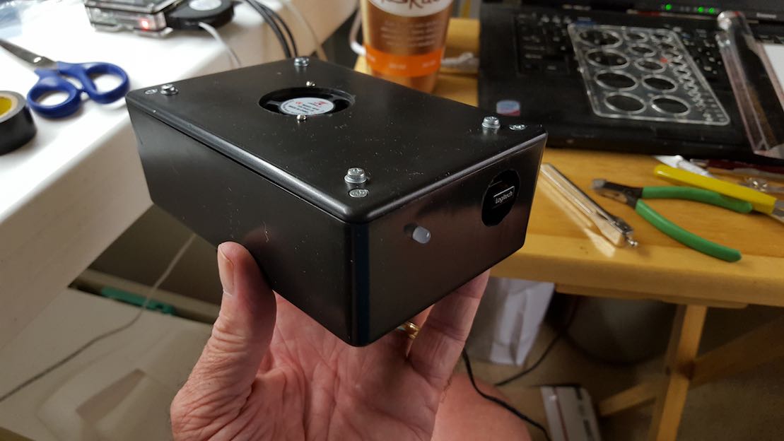

The front view of the enclosure is designed to be simple and functional. The power and reset switches ( external ) will be added later-- once I get them !  The LED in the front panel is the system LED brought forward with jumpers. I am using the system LED as a boot-up indicator and normal operating system runtime indicator. This LED is activated rapid flash at the point of rc.local in the boot sequence;  and there after drops into a slow flash to indicate normal operating system runtime and temps-- its pace picks up if the fan motor speed control bumps to 100% duty cycle ON.

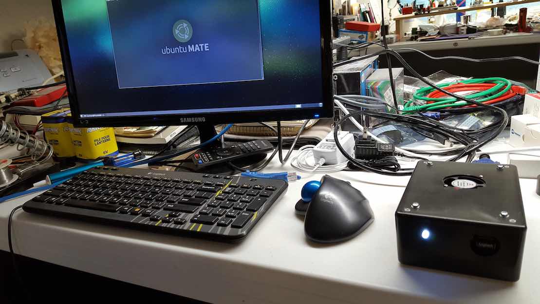

This is the ubuntu mate pineA64 board(B) booted and running normally;   Big Grin
... as well as some of the other junk in my lab.   Blush

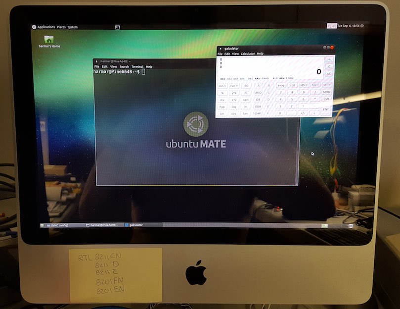

The pic above is the VNC (mate) desktop being displayed on my iMac with a -geometry of 1650x1040. When running on the local network, in full screen, this setup is very quick with very little interactive latency (neither in the mouse, nor in the keyboard).
I am starting the above vnc4server with :
vncserver :1 -geometry 1650x1040 -depth 24 -dpi 96  &
