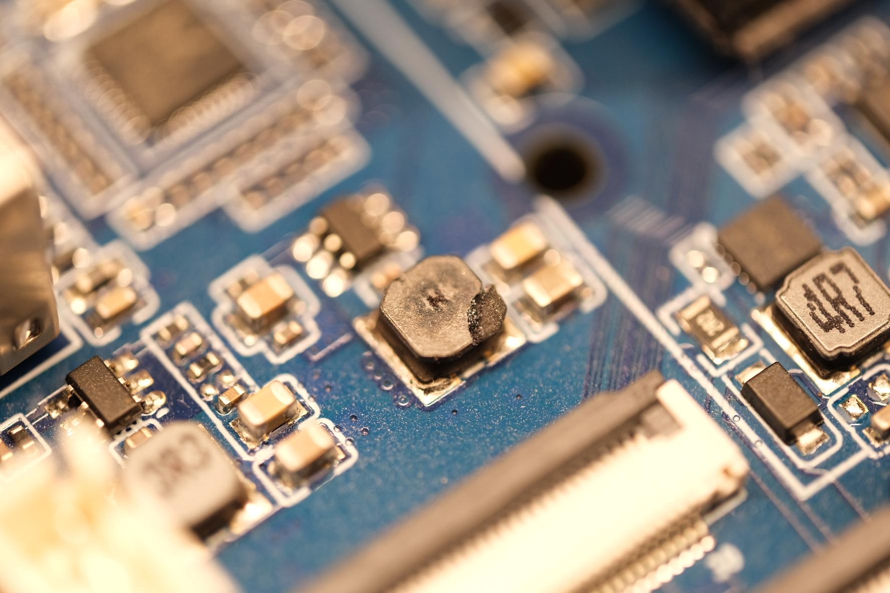

For the things dependent on the number of CPUs, I found a suspect:
I suspect this to be L9 or L10 from the schematics (EDIT: it's in fact more likely to be L2000, opening a different thread about that). I'll try to find someone who can help me replace that sucker. Before that, there's probably little sense in trying to resolve the other issue.
I got the inductor replaced which didn't change the error pattern at all.
