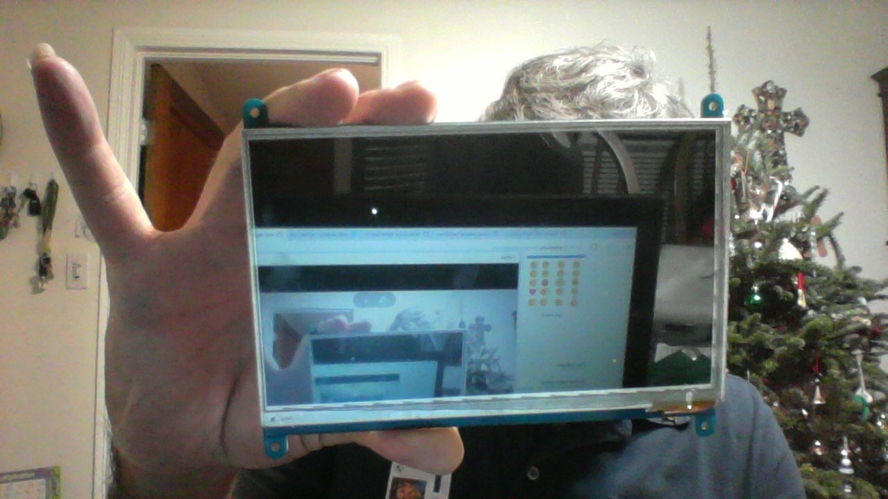

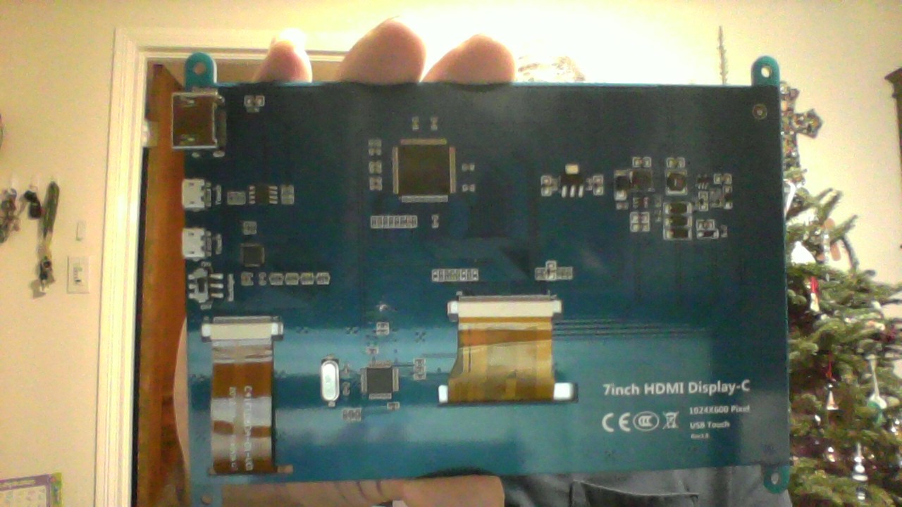

Hello All, I have the 2Gb board with WiFi/BT add-on. Using an Android image I can connect to most monitors. But I trying out a 7" Rasipberry Pi HDMI 1024x600 touch display. When display connected to Laptop HDMI Port display works fine but trying it on Pine board I get on display. Display powered by separate usb connection so I had it connect to a 5v brick. Board powered on and screen back light came on but not display on screen. connected pine to known good hdmi ported monitor and it worked. move cable back to Pi Display and no image.
If my Laptop can work with the Pi Display why cant pine64 work with it?
