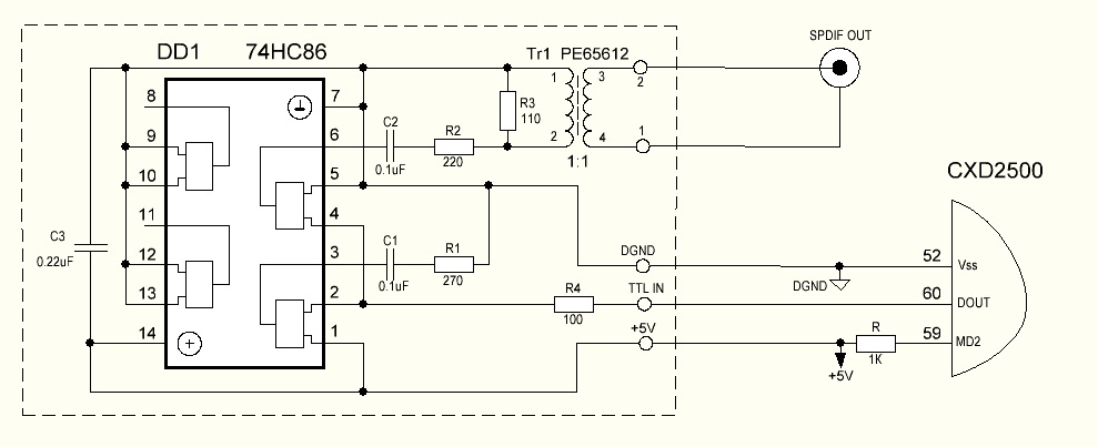

Hello!
I wanted to ask for connecting the connector SPDIF. Can I connect directly to the RCA connector pins 9 and 10 on Eruler Bus? Or need to use a scheme like this
(04-16-2016, 03:40 AM)RRomik Wrote: Hello!
The posted circuit may work. The coaxial (RCA) connector is 75ohm impedance, it is better to have TTL buffer between them.
Ok! Thank's!

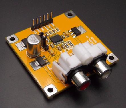

In case anyone is interested, I designed a simple board - an SPDIF to I2S or I2S to SPDIF converter. It's an open-hardware board and you can find the project here:
http://circuitmaker.com/Projects/55C2ED9...A529E312E9
(Circuit Maker is the latest Altium's product - a free yet quite capable PCB software based on Altium Designer).
With a help of a few cables it can be easily powered from PINE headers and connected to PINE's I2S.
Feel free to produce/modify it in any way you wish.
It doesn't have an optical transmitter or receiver, but the board can be easily modified to contain such (instead of an RCA socket).
