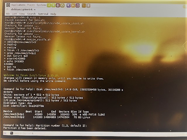

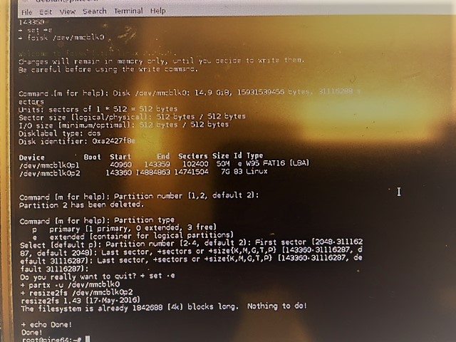

(11-16-2016, 07:08 PM)pfeerick Wrote:
(11-16-2016, 12:37 PM)bilylilyli Wrote: hi, how can I specify the path when I run the resize_rootfs.sh?
hi, I run those two command, and I attach the resuld. The first picture is for df -h and the second one is for fdisk -l.
When you look at the code for resize_rootfs.sh that I linked to earlier, it's pretty obvious that resize_rootfs.sh doesn't accept any parameters - it is hard-coded at lines 11 & 12 to resize "/dev/mmcblk0p2" - which is the second partition on your microSD card.
If you look back that df -h (or the fdisk) listing, you can see that you have /dev/mmcblk0p1 (50MB in size) and /dev/mmcblk0p2 (7GB in size). /dev/mmcblk0p1 is a boot partition, and if you look at the microsd on a Windows machine, that is all you will be able to see (without installing extra drivers / software). /dev/mmcblk0p2 is the actual data partition for linux, and that is the one that should be resized when you run resize_rootfs.sh. The problem now is in knowing why the resize has failed, as you said this is on a 16GB microSD, and it hasn't been resized up to use the full 16GB. Do you get any errors or output from resize_rootfs.sh when you run it again (make sure you're running as root).
Can you give the link to where you got the image from or which version it was, - as I indicated earlier, there was a older image that had a bug in resize_rootfs but that was fixed about three-four months ago, so I just want to make sure that image is not still linked as a current image somewhere.
hi, I have upload the screen capture for the output from resize_rootfs.sh. It did not show any errors, but nothing to do.
And the image I download is the "debian-mate-jessie-20160701-lenny.raposo-longsleep-pine64-8GB"

(11-17-2016, 01:12 PM)bilylilyli Wrote:  I have upload the screen capture for the output from resize_rootfs.sh. It did not show any errors, but nothing to do.
and this is the link
This error message is classic.
... the date on the repo is the key 07-01-2016 is the back-level ( very old ) image.  This is the image where the 'broken' resize_rootfs.sh  was discovered  ( I am actually the one who discovered it, and I was the one who worked with lennyraposo to get it fixed ).
Unfortunately, it is 'still' broken. The script will run, you will get no errors, but it will report that there is nothing to do...   again, classic.
If you put the SD card in another computer and run gparted on it, you can resize it there;  otherwise, keep whining about a very well known issue like its today's news !
