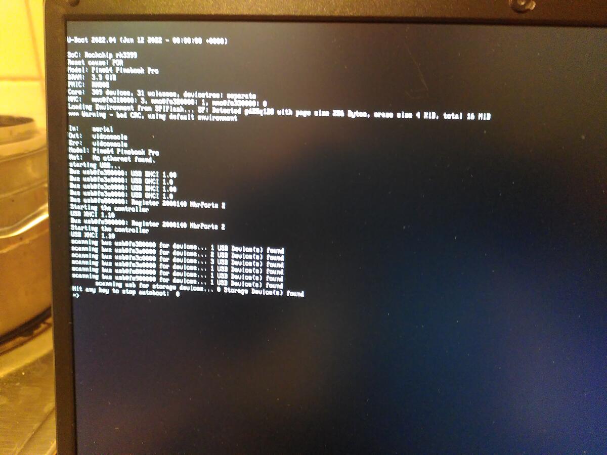

First, I interrupted the boot process on the old PBP, and I get a prompt in u-boot. Maybe there is something I can do at this point to get Tow Boot (from the SD card) installed to SPI?
(This happens with SD card inserted.)

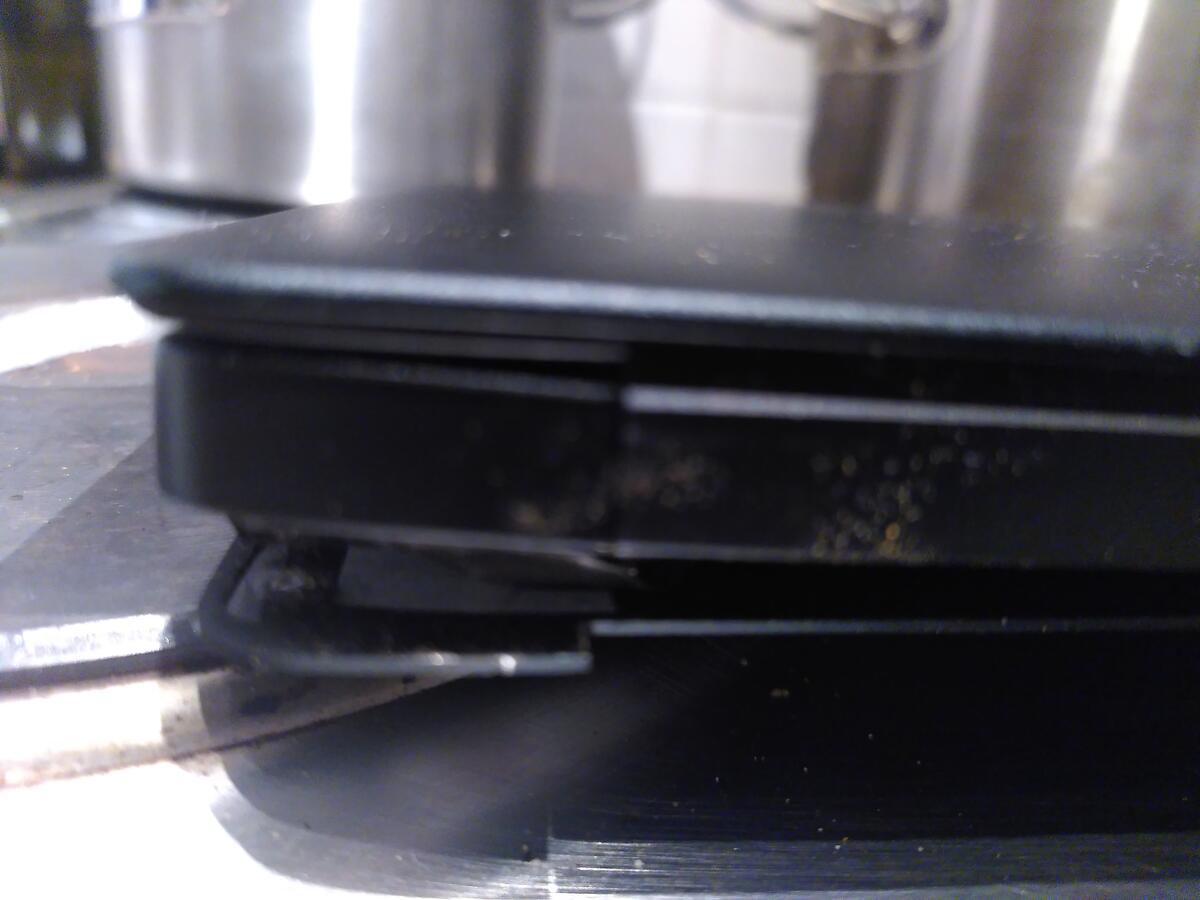

Second, the picture to come should show how it looks, basically because of the broken plastic I cannot get the bottom case fixed. I was wondering whether I could use the old PBP (in case I don't get to fix the power-on problem) as a spare part, instead of https://pine64.com/product/pinebook-pro-bottom-case/ (which is out of stock anyway)?

@zkajdan no worries!
concerning uboot, i don't believe there's an easy way to use uboot to tell the pbp which drive to boot from. in fact, if you're seeing that, it would indicate to me that the pbp has already selected and booted a drive (likely the emmc.) the "easiest" way to ensure your PBP boots from the TowBoot installation SD would be to disable the emmc using the internal switch. that will prevent anything already installed from interfering with booting from the SD card. After booting from the SD card and installing TowBoot, you should be able to power down, insert your OS install SD, and when you boot back up you should see the TowBoot logo in the corner with a key interruption option to select your boot media manually.
concerning the possibility of swapping out the part from your older PBP, i do believe that would be possible. though the PBP has undergone some revising between batches, i do not believe any of them were major enough to warrant changing the primary body pieces of the laptop itself. if you wanted to double check, whenever you remove the bottom cover to fli[ the eemc switch, you could put the 2 next to each other, with both bottom plates removed, and compare all the mounting locations. everything should matchup.

... and so I did it today and the PBP survived, but ...  Shy  ... the exact same thing happened ... I don't really understand how that's possible, I remember that for the other PBP, it also seemed that the switch was off before, I turned it because I thought it might have been labeled the wrong way round - same thing here, it looked like the emmc had already been disabled, I switched it, but the behavior is the same as before: u-boot starting (see pic above)...
No idea how that's possible really Sad
#19
Yes, the switch is mislabeled, think short (clock) disabled, so there is a emmc clock working since not shorted
you have a uboot prompt, type help
also.... mmc help
that version of uboot is either not scanning mmc or card is not setup right
(or not a good card)
try writing the image to a usb stick, try BOTH usb sockets
is it a 1 or 2 partition image?
uboot will be looking for either boot,scr or extlinux.conf or aarch64.efi (only 1)
any of these must be in correct location
as well, sometimes the paths in extlinux.conf can be wrong, paths are in relation to itself,
I had that happen only last week from my inherited son's pbp
