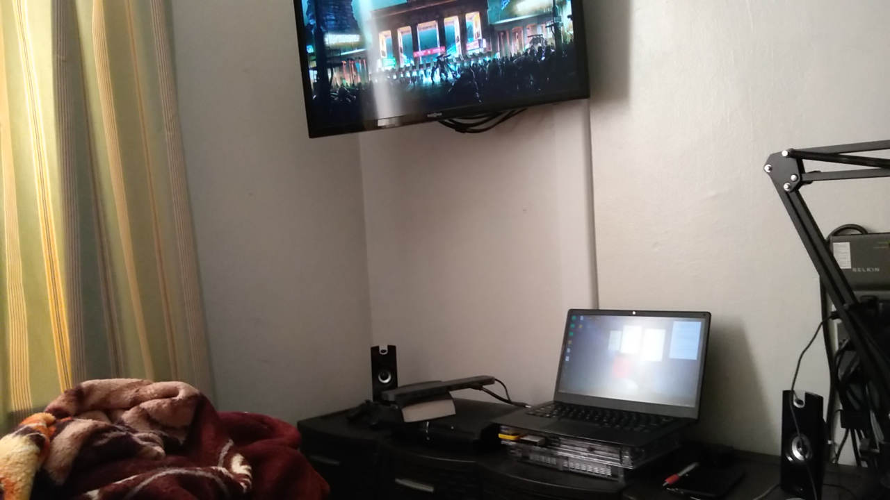

Thanks man, I actually switched the usb switch upside down and also powered the pbp on with the usb c dock.. boy this is a weird issue..
.jpg   IMG_20200903_141957.jpg (Size: 318.95 KB / Downloads: 854)
