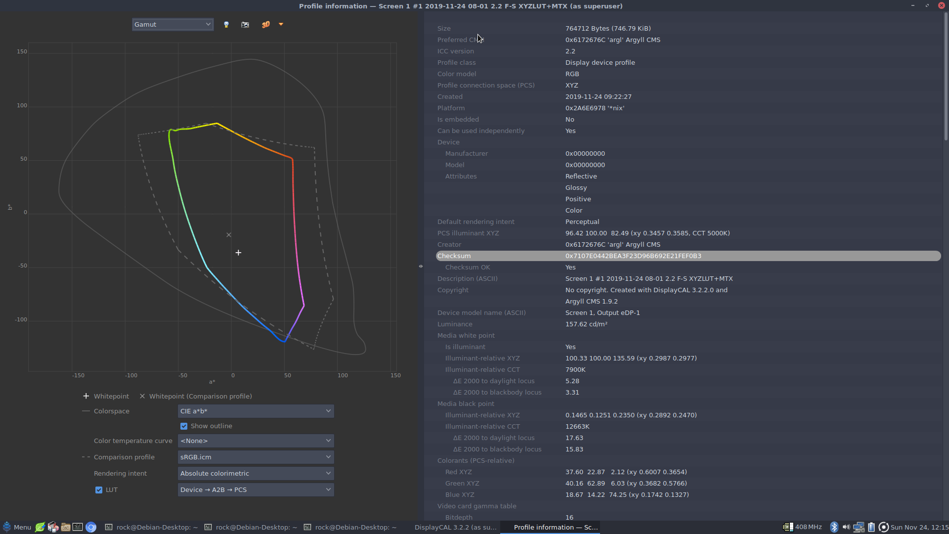

.png   Gamut.png (Size: 214.47 KB / Downloads: 991) I have the archive with the .icc profile that Argyll/DispalyCAL created for me...but it is slightly too large to attach...I will just attach the .icc for now and some screens.  In a rush and the icc has a crazy long name...probably want to rename it.

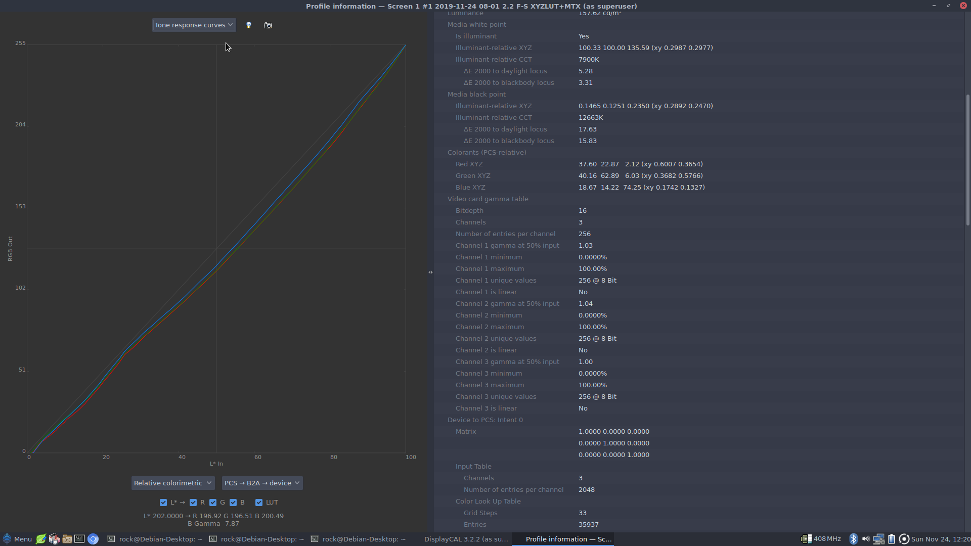

OK, I'm back home and tried to use xcalib to load the profile and I get "unsupported ramp size 0" errors but dispwin -v Pinebook.icc (this is the name of the profile I created) seems to work.   I say "seems" because I do not see a screen change in color or temp or anything else.  Dispwin -V Pinebook.icc seems to verify it is loaded....   I just don't know.
Anybody else try it?
.png   ToneCurve.png (Size: 180.95 KB / Downloads: 818)
