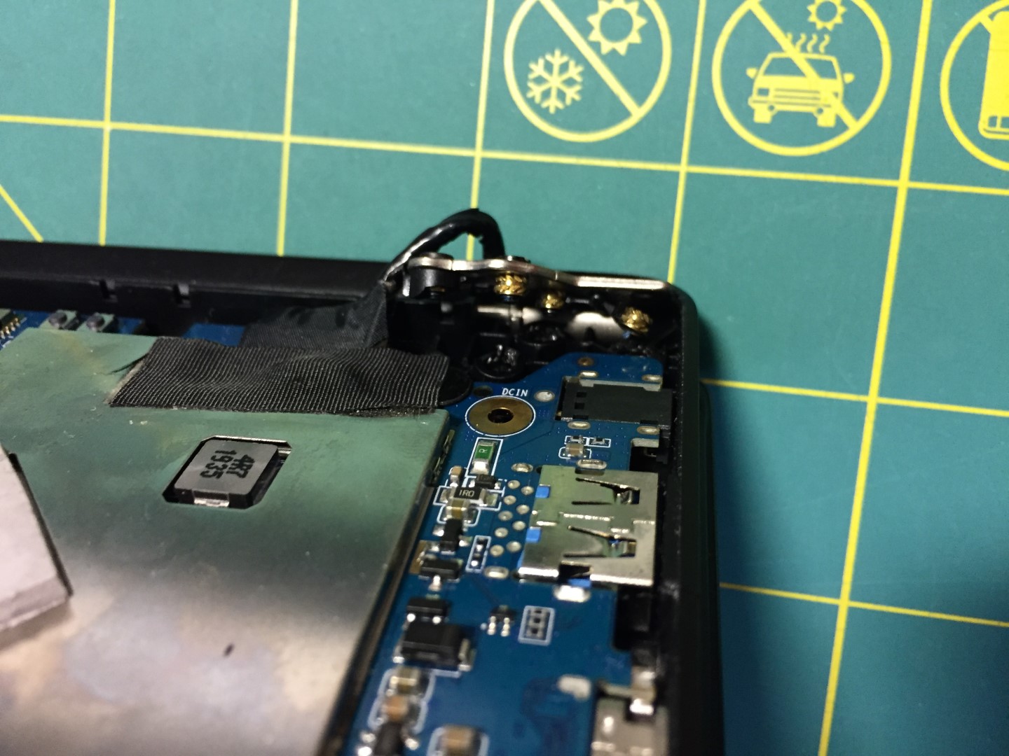

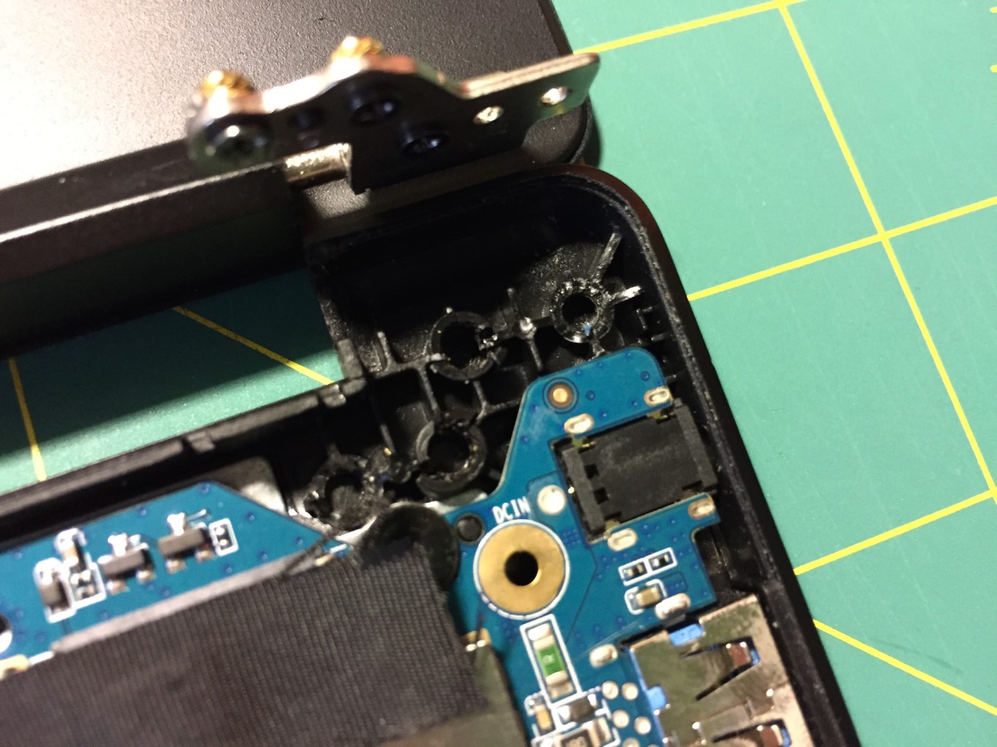

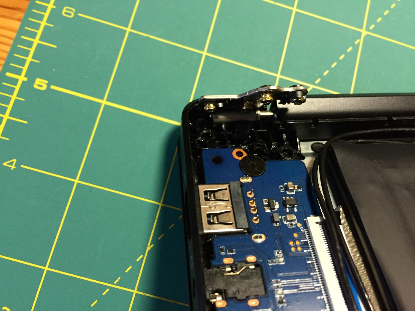

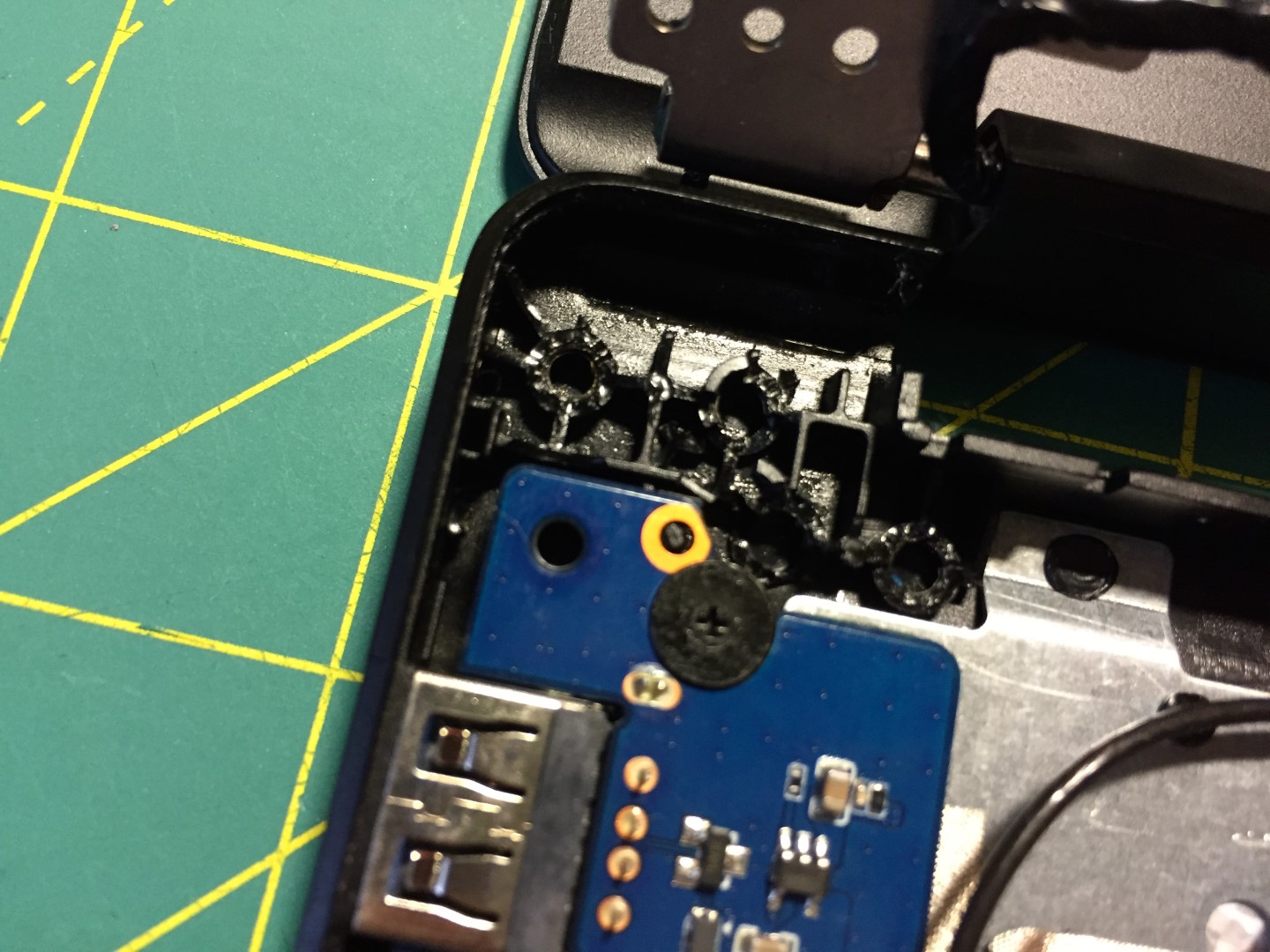

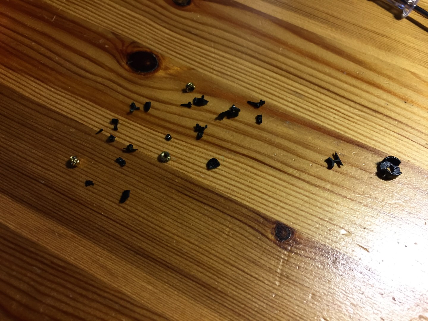

Both hinges completely failed
Sad to announce that both the hinges have completely failed on my Pinebook Pro. The plastic holding the brass inserts have broken into numerous tiny pieces. The plastic bits feel oily to the touch and extremely brittle. I guess I will repurpose my PBP into a headless machine.
If you reach out to Pine, they should in theory be able to run a few more of the shells in the production process. Running a few extra should be pretty cheap for them. Then you can transplant the guts over.
Might be worth Pine checking out different types/grades of plastic too.
I wonder if the hinges were lubricated, and if so, was the lube incompatible with the plastic. If that's the case, and it sure seems like it, they might want to know, to avoid this problem in the future. It would be nice to know which batch yours came from. But then, it's hard for anyone to really know that.

those plastic palm cases are the weakest spot to mount those hinges on ,
finally mine starting to show cracks.,even mildly using the pbp.
definitely a structural design weakness ...only an embedded steal plate or metal rest would change that
