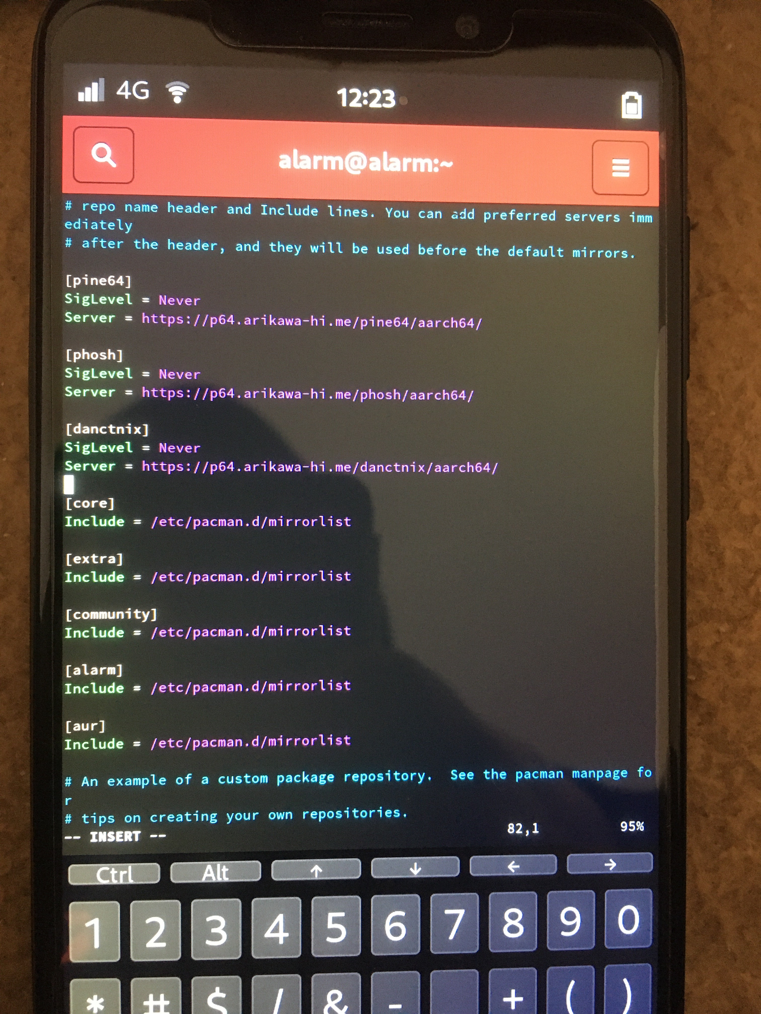

(10-24-2020, 10:31 AM)Veraendert Wrote: If someone has the same problem updating like me: You need to add another repo first in /etc/pacman.conf
https://discord.com/channels/37059558709...9401141268
Please provide the actual information. A link to an outside site which requires javascript to function is inaccessible to many.
TIA
LF
NOTE: For anyone from previous builds, please add this repository to /etc/pacman.conf: -- it should look like this after done
[danctnix] SigLevel = Never Server = https://p64.arikawa-hi.me/danctnix/aarch64/
No need to go to discord at all.
https://github.com/dreemurrs-embedded/Pi...g/20201024
HTH
LF

4th upgrade was successful after adding the repository. It is the best of the releases, it is the worst of releases.

As for sounds, you need to do pacman -Syuu to downgrade the PA package (if the repository was added before [core] order), the latest PA has issues on the PinePhone. On new images this is not needed.
