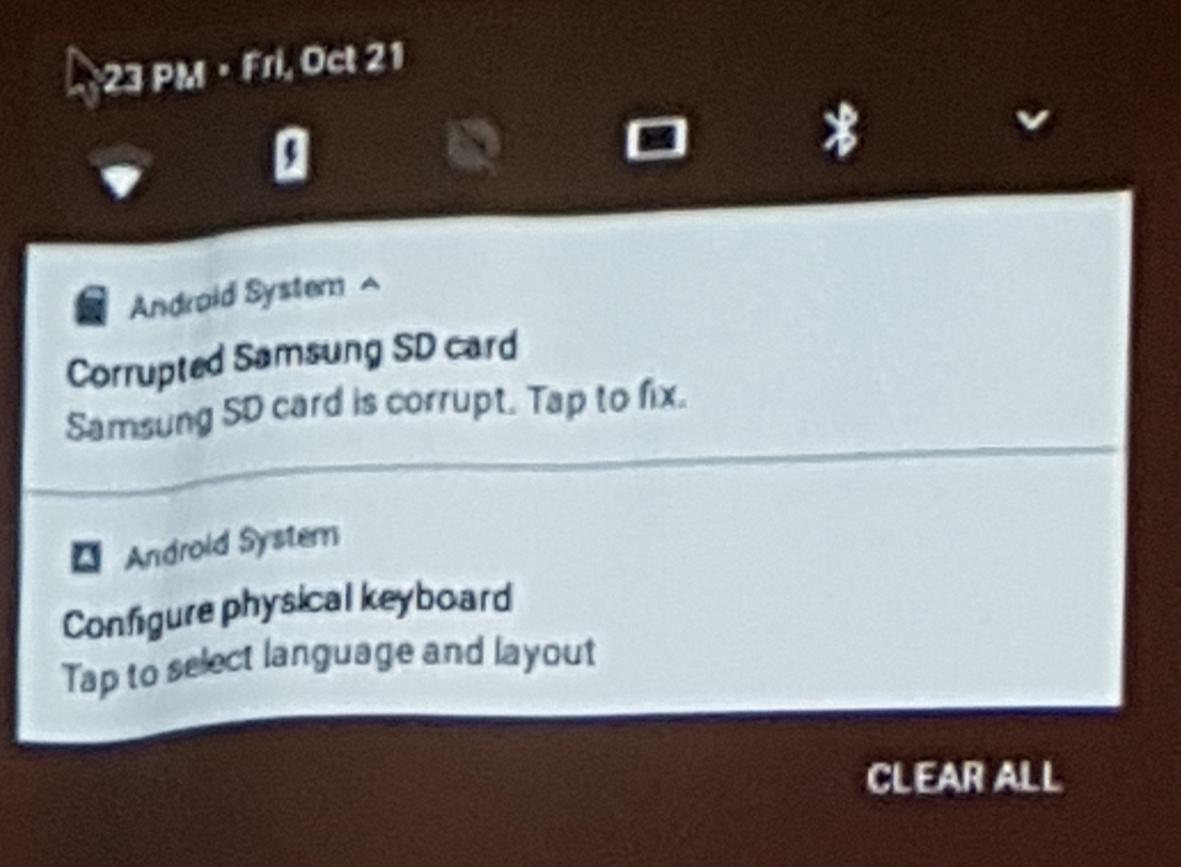

I have burned the latest available Android 7.0 image (android-7.0-pine-a64-v1.7-r54.img) on my fresh Samsung EVO Plus 64GB SD card, and it boots fine and extends the 4th partition to the end of the available space nicely.
But there is one glitch, right after I get to the home screen: it says the SD card is corrupt. And I am afraid that's a lie, because it says to also with two other cards.

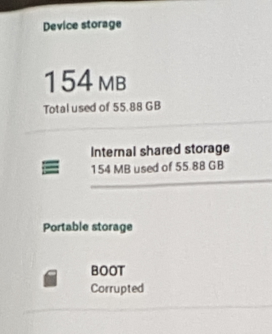

Attached are the screenshots (well, photos of projector images) with notification list and the Settings/Storage view.

Hi. I think there was a mention of the corrupt SD card message being a known bug on the main Android 7.0 thread, but I can't find it right now. I get that message also, but am able to use the OS just fine.
(10-22-2016, 06:53 AM)Ghost Wrote: Hi. I think there was a mention of the corrupt SD card message being a known bug on the main Android 7.0 thread, but I can't find it right now. I get that message also, but am able to use the OS just fine.
Does it reboot for you with no problems? And the Corrupt SD card notification is just constantly there for you, also after reboot?

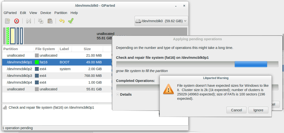

Since I could not boot up Pine64 after shutdown, I burned the image anew, and then (instead of booting it up on Pine) launched GParted to see if it has anything to say about the BOOT partition. At the partition list it did not have any warnings, but when doing the check on the BOOT partition, it have me this error (attached screenshot). I have no idea if this error is somehow related to the notification in the Android about the corrupted SD card, and whether it is related to the boot problems after Android is shut down.
I can check the contents of that partition on my Ubuntu without any issues - open the files, etc.

Now the only thing left is to understand where to copy my large files (ie, movie and audio library) so that they are normally accessible from the Android. Its not exactly clear where is the right location (attached file manager screenshot).
I know Gparted takes issue with overlapping partitions present in some Android builds, not sure if that is a factor here or not.
