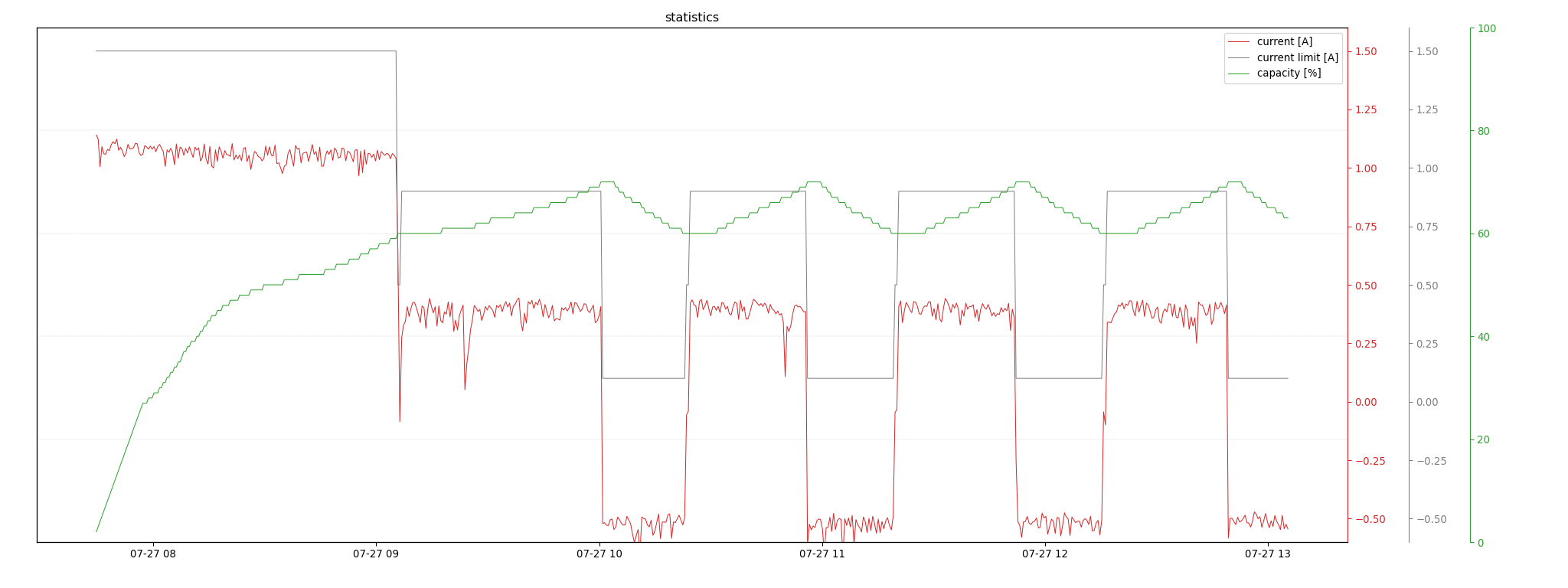

Using a python script to create a poc.
I could not find a setting to disable charging. Since pp draws more than 0.1A it's sufficient to set the current limit to 0.1A.
    'battery_current': {
        'filename': '/sys/class/power_supply/axp20x-battery/hwmon4/curr1_input',  # noqa E501
        'description': 'battery current in mA'},
    # 'battery_voltage': {
    #    'filename': '/sys/class/power_supply/axp20x-battery/hwmon4/in0_input',
    #    'description': 'battery voltage in mV'},
    'usb_current_limit': {
        'filename': '/sys/class/power_supply/axp20x-usb/input_current_limit',
        'description': 'usb current limit in µA'},
    'usb_charger_current_limit': {
        'filename': '/sys/class/power_supply/axp20x-usb/usb_dcp_input_current_limit',  # noqa E501
        'description': 'usb charger current limit in µA'},
    'battery_capacity': {
        'filename': '/sys/class/power_supply/axp20x-battery/capacity',
        'description': 'battery capacity in %'},
    'usb_charger_online': {
        'filename': '/sys/class/power_supply/axp20x-usb/online',
        'description': 'charger is online'},
