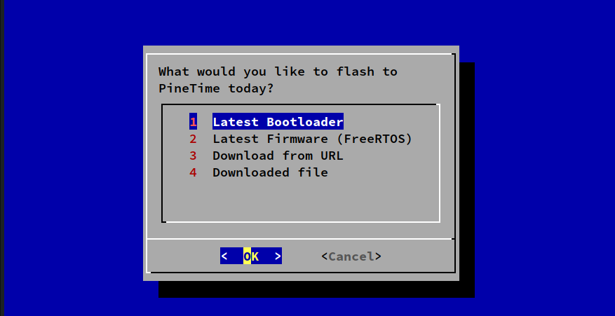

Hi All: Do you have an ST-Link or Raspberry Pi?
Here's a simple Bash Script that flashes the latest Community Bootloader (MCUBoot ported by me) and Firmware (FreeRTOS ported by JF) to your PineTime...
https://github.com/lupyuen/pinetime-updater
This is the very same bootloader and firmware that we are asking Pine64 to preload at the PineTime Factory. (Thanks Pine64! We  Heart You  Smile )
So go ahead and flash your PineTime now... For that Fresh From The Factory Feeling  Smile
.png   pinetime-updater.png (Size: 20.76 KB / Downloads: 496)
Works for me with the pi. It would have been nice if it had found and used the existing ~/openocd-spi from previous tutorials, but I guess the target audience wouldn't be expected to have been through those.
Great thanks! Now that we are preloading FreeRTOS, I thought we should simplify, make a clean start and decouple openocd-spi from Mynewt :-)
Moving ahead I'll be using Mynewt more as a "Utility Firmware" for specific tasks... Like for loading a custom Boot Logo. Also for updating the PineTime MCUBoot Bootloader.
