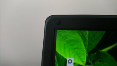

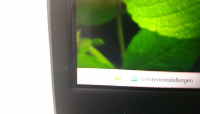

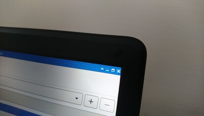

I am very pleased with my Pinebook Pro.
However it seems my screen has some really nasty offset resulting in a two-millimeter black bar at the left-hand side and the bottom and some pixels vanishing at the top and the right-hand side (see attached files).
The screen seems to be glued-in so I guess my only chance is to "unglue" it, try to move the screen and then somehow glue it back!?
Does anybody else have this offset?

The pinebook pro I received also had its LCD panel set too high and too far to th right:
[Image: 31C8E734-A8CA-4A67-B157-74B69ECFF984.jpg]
I was able to right it by prying of the bezel (there are two screws the rubber stickers that need to be removed first) and then gently moving the panel.
