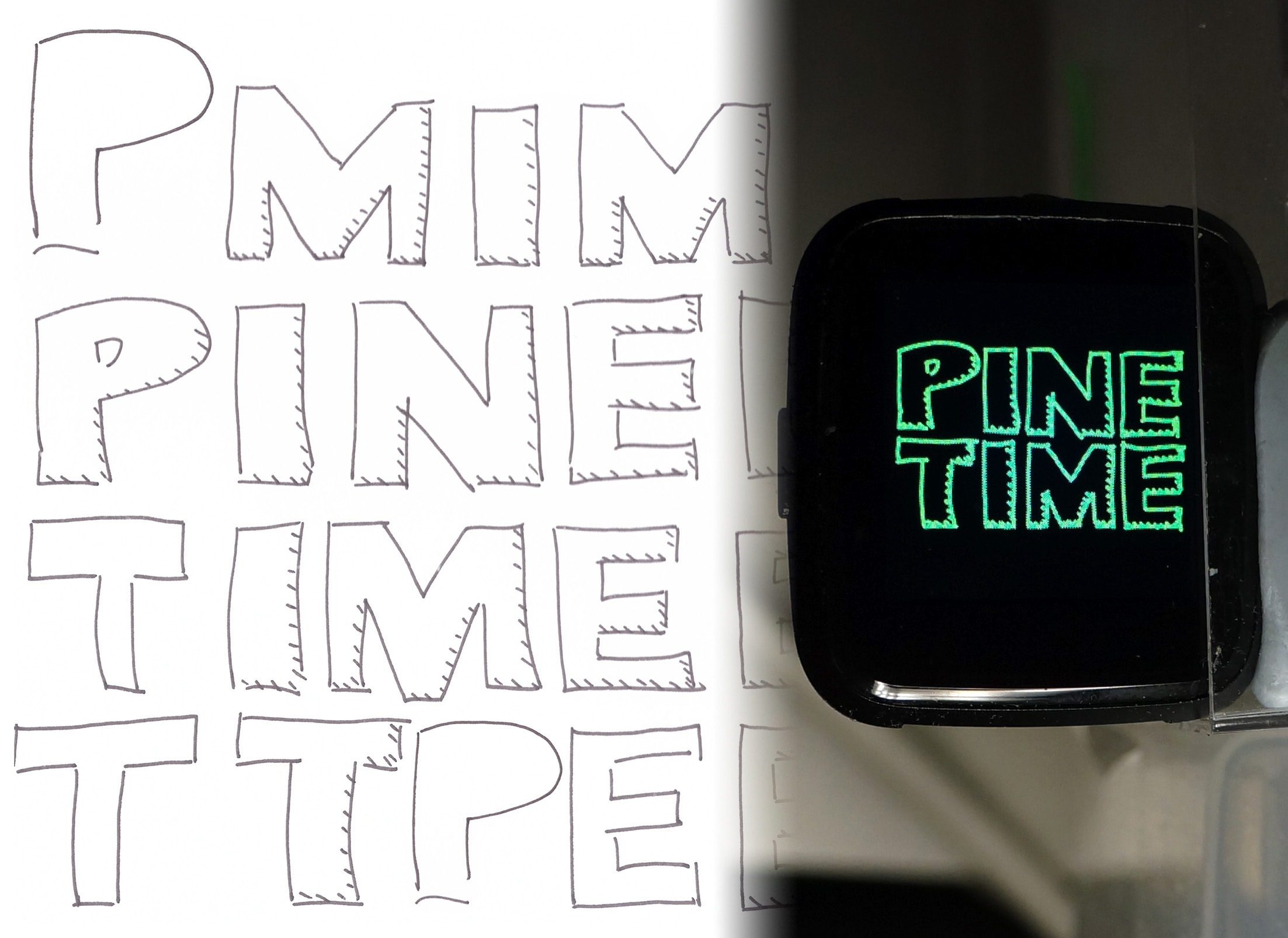

(4) MCUBoot now displays a graphic image stored in SPI Flash while booting. This is needed because we have to show something during the 5 second delay. Also when MCUBoot swaps firmware during upgrade
(5) I have created a tool that loads a 240x240 PNG file into SPI Flash for display by MCUBoot: https://github.com/lupyuen/pinetime-graphic

.jpg   pinetime-graphic-photo2-small.jpg (Size: 424.73 KB / Downloads: 659)
Here's a video of the Enhanced MCUBoot Bootloader that displays the boot graphic stored in SPI Flash...
https://twitter.com/MisterTechBlog/statu...76544?s=19
