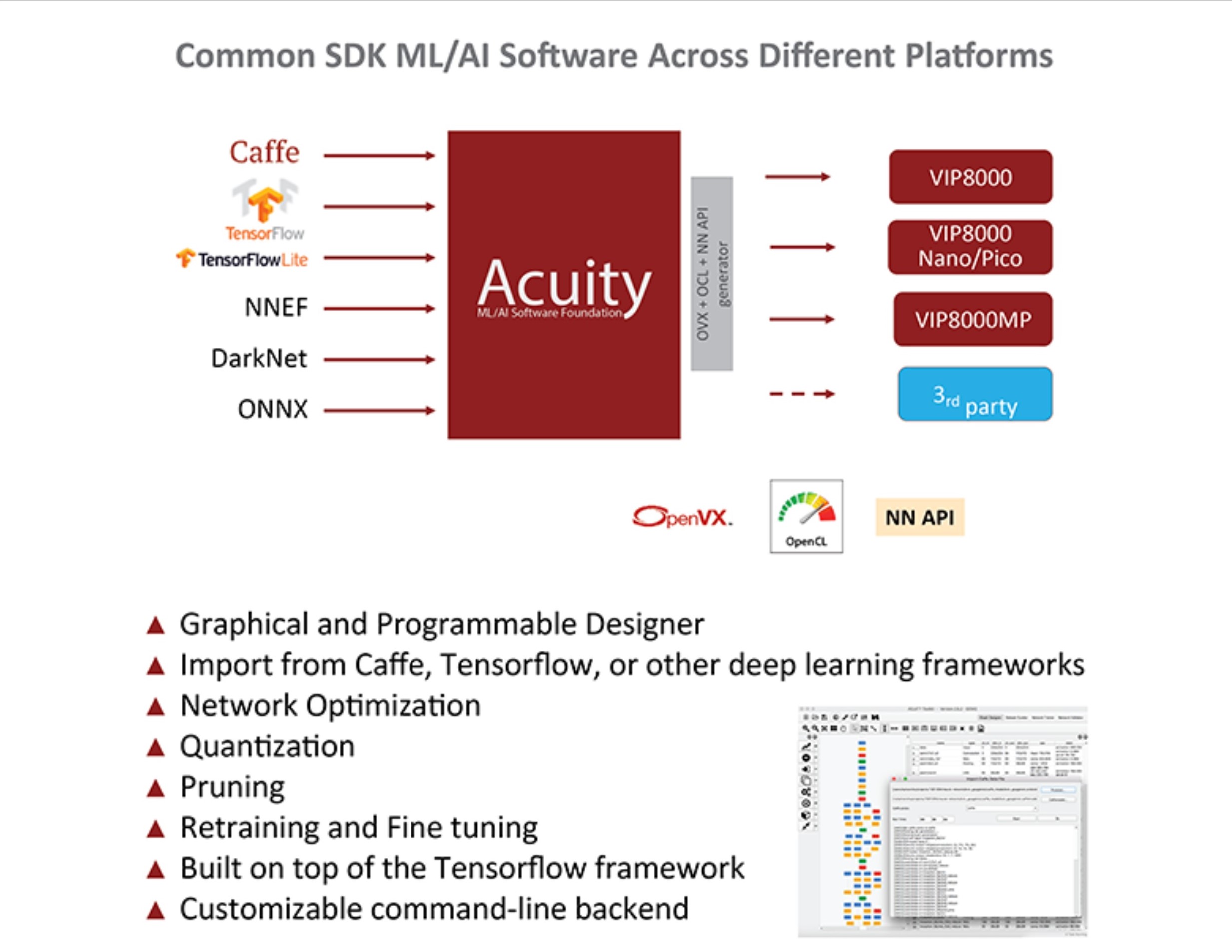

When the SoEdgde plug into clusterboard, the USB port on the clusterboard still maintain as USB 2.
The NPU on SEdge same as the one use by NXP Vivante and the API should works on both platform, please refer to attach diagram. The Tensorflow model should work.
