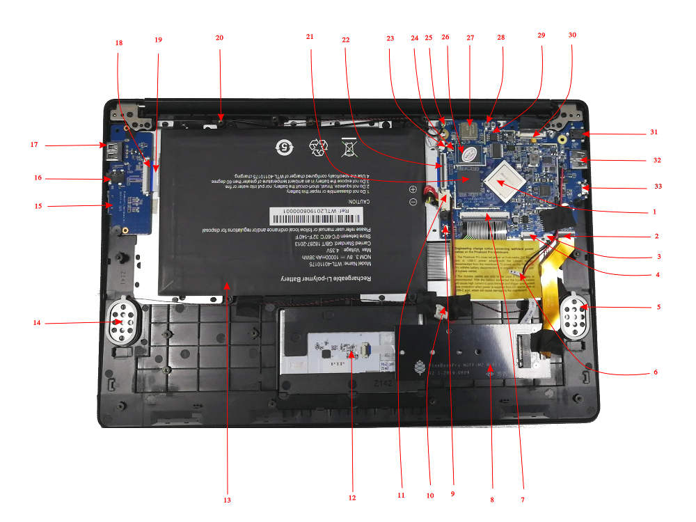

One way or the other the button works shorting two pins in an SPI device. But in some cases it just does nothing. So if you experience such problem there is a way to overcome it. You can short the two pins by yourself.
Procedure:
1. Unscrew bottom cover.
2. Remove the metal shield surrounding main CPU - it is held in place by a tape and micro clamps on pcb.
3. Disconnect all (!!!) boot devices (emmc, sdcard, usb).
4. Locate SPI flash (number 29 on picture).
5. Connect pbp with USB-C - USB-A cable to another computer (pbp on USB-C side).
6. Turn on pbp, short pins CLK and VSS and press reset. It should get your pbp into maskrom mode.
Procedure:
