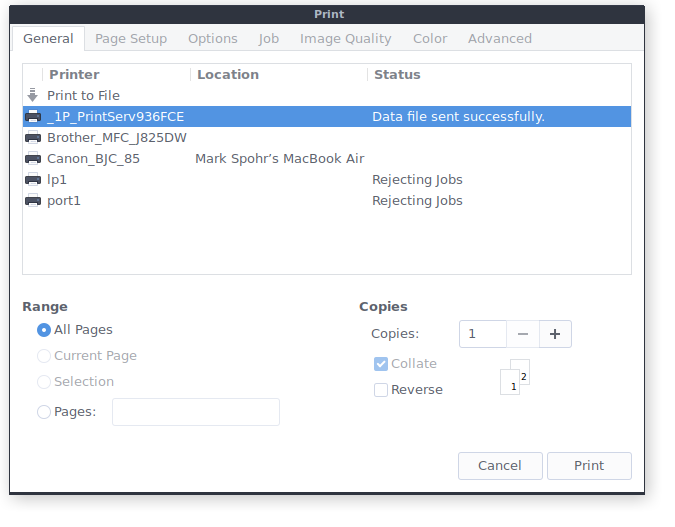

After I installed CUPS, I get this screen which shows my printers when I CTRL-P
This is very encouraging. However, none of these work. They print mostly blank pages. They must need printer drivers.
The localhost:631 doesn't show any of these printers and I can't find them with Search.

(12-10-2019, 05:23 PM)mspohr Wrote: They must need printer drivers.
I think you will find that there isn't a lot of support from printer manufacturers for arm devices. There are cups drivers for both those printers. But it looks like they are only for i386 or x86_64, not for arm devices.
