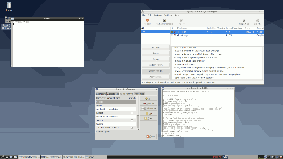

Got it, some time I'll document the process better.  Seems like everybody makes a minimal image and usually a bloated one that still doesn't have what I want.  Basically I installed a few X applications like Firefox and Gimp, LXDE, xinit then started fixing what was missing by looking at the xorg log.
