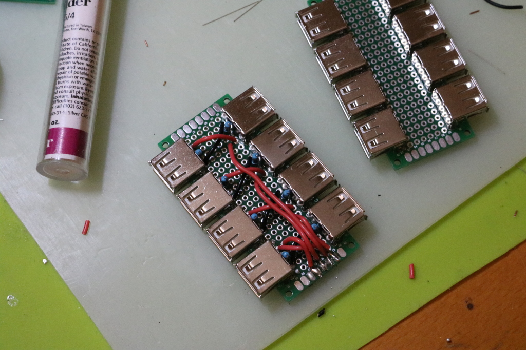

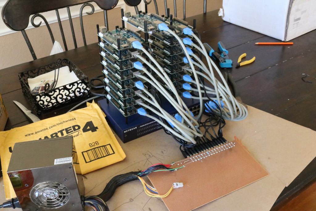

(04-28-2016, 11:33 AM)hazerty Wrote: you have buy 17 boards? Yeah I have 17. (04-28-2016, 09:39 AM)tkaiser Wrote:(04-28-2016, 08:40 AM)jproffer Wrote: I'm using my pines as a computing cluster with 4 nodes (4 per node) mainly I'll use it for thermal/stress simulations, and probably a bunch of folding@home projects in its downtime (04-28-2016, 11:48 AM)jproffer Wrote: mainly I'll use it for thermal/stress simulations, and probably a bunch of folding@home projects in its downtime Ok, unfortunately it's already too late but maybe this helps others to improve their cluster setups: We did already extensive research on performance related topics. If you've an hour please read through https://github.com/longsleep/build-pine6...-191984162 where most if not all problems are outlined.

I am also thinking about creating pine cluster. Probably 17 boards too. Mostly for distributed algorithms development (databases, programming language research, raytracing, etc). But I am still thinking between Pine64+ and RPi3 B. Pi people and Broadcom promised to support PXE booting without sd card (you can already do nfs root over network, but you still need to use a bootloder using small sd card), by just putting few pxe related bits (tftp client, dhcp client, ethernet driver, etc) in the rom/flash itself. I doubt we will see this on Pine. Maybe on next version of the board, which will not happen this year for sure.

(04-28-2016, 12:22 PM)tkaiser Wrote:(04-28-2016, 11:48 AM)jproffer Wrote: mainly I'll use it for thermal/stress simulations, and probably a bunch of folding@home projects in its downtime Thanks for the info, it's interesting, I hadn't realized the microusb would be limited to 1.8 amps, but it does make sense now that I think about it, and I did confirm its limitation. Euler it shall be, then. Heatsinks are definitely in the plans. My setup doesn't even have the microsd cards configured yet - just testing out the USB power hub currently -- it took alot of time to build. Well at least now I have a kickass phone charger, haha! (a 470 ohm resistor between the data pins ensures maximum current draw for devices like the iPhone, for what its worth). I was planning to set cpufreq to performance (1.2ghz). I'll have to test it out and see how it performs, and tweak as needed. You make it sound like the board is a flop -- hopefully I won't be disappointed..
(04-29-2016, 03:51 AM)tkaiser Wrote:(04-28-2016, 11:09 PM)jproffer Wrote: You make it sound like the board is a flop So, I tried powering up a Pine64 board using Euler, connecting +5v to pin 4 and ground to pin 6. The board's LED did not come on. Am I missing something? (04-29-2016, 08:51 PM)jproffer Wrote:(04-29-2016, 03:51 AM)tkaiser Wrote:(04-28-2016, 11:09 PM)jproffer Wrote: You make it sound like the board is a flop never mind, I got it working. I was using my breadboard to test it with and one of the pins wasnt pushed down far enough. |
