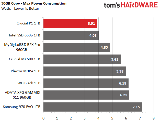

Data on SSD power consumption is not very widely available, but this comparison might explain why we had the least issues with the Crucial P1, and were able to reproduciably crash the RockPro64 with the Samsung EVO 970.
https://www.tomshardware.com/reviews/cru...852-2.html
[Image: z-Vp-H3kxo-Sk-C8qr-Rh-Mrr-UY8-650-80.png]
