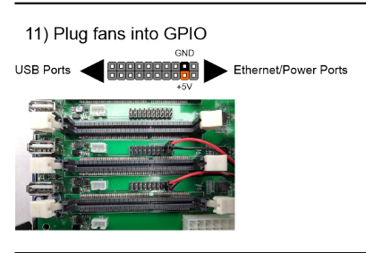

is anybody using the C4Labs clusterboard case and the fans?
what is the best way to power them up?
i have connected them as described in the docu, but they are not spinning up.
kind regards,
langerma

Actually,
If you look at page 3 of the description there seems to be an error in the documentation.
Under 11) it lists +5V as being close to the sophine socket. But the photo actually has the cables the other way around.
That might explain a lot.
And I think they will not work without a module in the slot. But that is just a guess.
Regards, Hugo.
