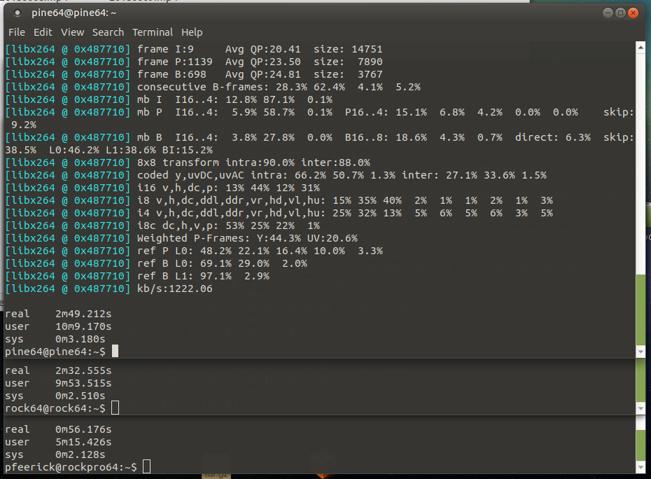

So, since I've got both the pine64, rock64 and rockpro64 on the bench atm, and am playing with some timelapse video conversion... I thought I'd run a job on all three and see what the results were.
Unsurprisingly, the rockpro64 won the race. I was surprised to see the pine64 wasn't that far behind the rock64, but then again, I'm not doing anything that I think would really take advantage of the hardware encoding...
Now this wasn't that hard a job, stitching together some 1800 stills into a around 90 second timelapse, but it still illustrates the performance difference between the boards at this stage, with what is likely to be sub-optimal encoding settings.
And because evilbunny made me pull out my pineH64 and run linux on it... it gets a mention also, but it is a dishonorable mention as the Linux image I have for it is barely enough to boot it, and it is seriously un-optimised ...
real    2m48.377s
user    10m49.964s
sys     0m1.980s
pfeerick@pineh64:~$
(06-09-2018, 03:31 AM)pfeerick Wrote: So, since I've got both the pine64, rock64 and rockpro64 on the bench atm, and am playing with some timelapse video conversion... I thought I'd run a job on all three and see what the results were.
real    2m48.377s
user    10m49.964s
sys     0m1.980s
pfeerick@pineh64:~$
