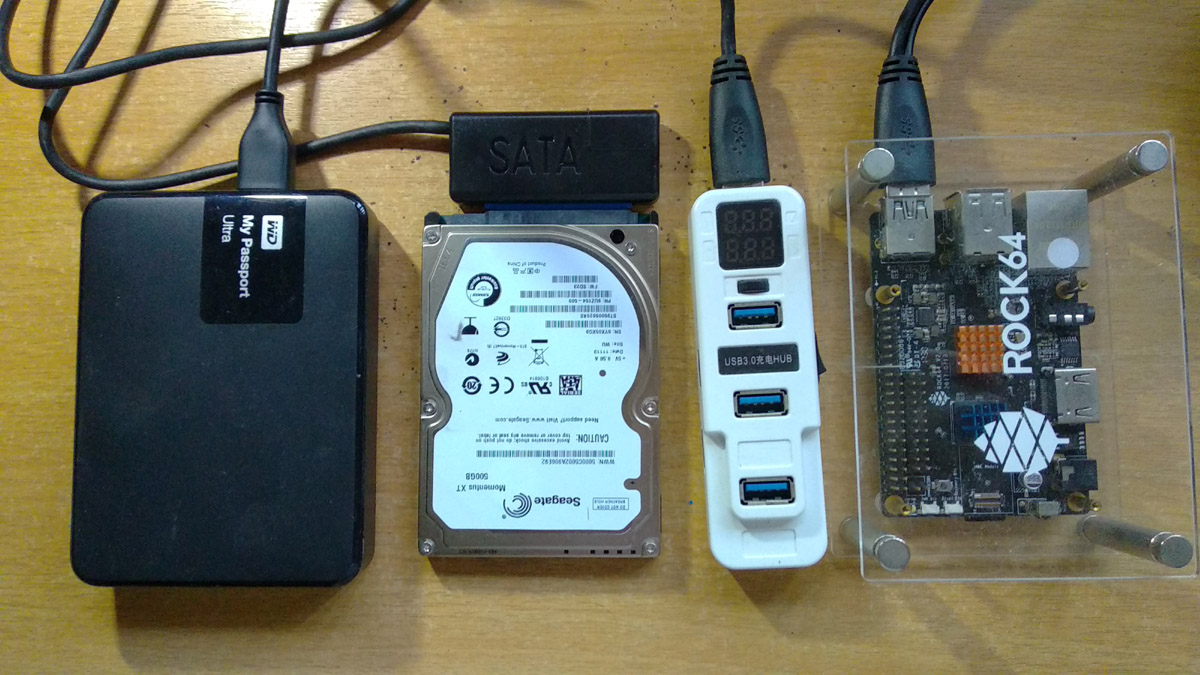

My powered USB 3 hub is not even a branded one but it does the job well. I am not on RAID though. Anyway here is my setup:
2GB Rock 64
Stock power supply for Rock64
Unbranded powered USB3 hub
500GB Seagate HDD where the Linux file system is
4TB WD My Passport Ultra USB 3.0 drive.
