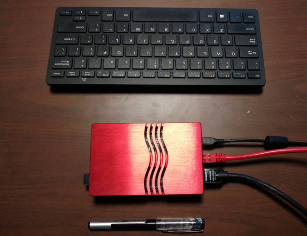

Yep, I was thinking of the LTS. The case is nice, and acts a good heatsink. I cart this around my company when I get asked by management: "Yeah, well what kind of hardware is required for an application like that?".
Here is the pine64 when I fist put it together in March.
